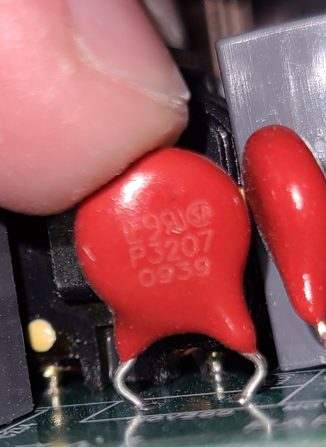

Hello. I am replacing some bad MOVs and am unsure on the correct part to replace them with

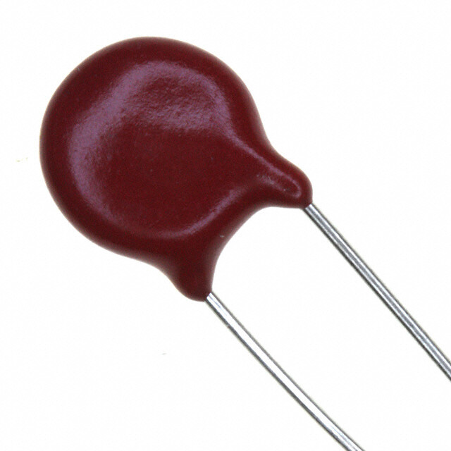

V320LA7P Littelfuse Inc. | Circuit Protection | DigiKey

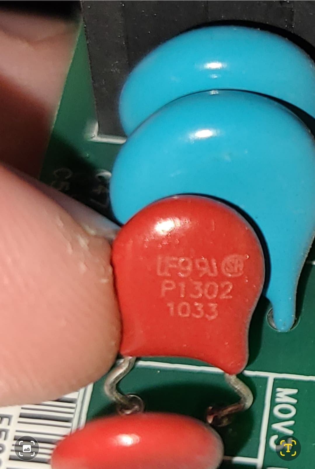

Regarding the P1302
marking LA series from Littelfuse.
Datasheet - https://www.littelfuse.com/assetdocs/littelfuse_varistor_la_datasheet.pdf?assetguid=f7c547ce-c2fa-4789-86cc-ec39a5060afb
Part Number V130LA2P
F3002-ND
