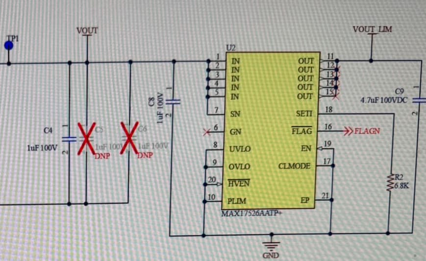

I am using the MAX17526A current limiter in an embedded design. The input voltage to the current limiter is +30.5V. The schematic below shows my configuration of the part. My current limit setting, with R2 at 6.8k ohms is ~5.5A. I have experimented with the part in “auto retry” mode (as shown in the schematic) as well as continuous mode where the ‘CLMODE’ pin is floated.
The FLAGN pin is connected to a pull up resistor to 3.3V. This is done on another section of the schematic that I didn’t attach.
The load that this part is connected to “VOUT_LIM”, is a combination of inductive motors, piezo transducers as well as several buck converters, various microprocessors and integrated circuits. So, the load definitely has both real and reactive components.

So, I am just wondering why the part does not behave as expected when using it with a programmable load versus a purely resistive load? I am guessing the answer has something to do with the active nature of how the programmable load develops its apparent load at any point in time and the interaction of this with the control loop in the MAX17526A part attempting to limit the current. I have also tested my programmable load independently, connected to a power supply and it is working fine. So, it’s only when I attempt to use the programmable load as the load for the MAX17526A when the results are not as I would expect.

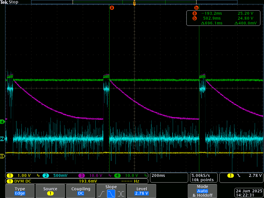

Below is an O-scope image showing the MAX17526A part driving the actual load (not the programmable load). The /FAULT line trips several times as we reach the 5.5A current.

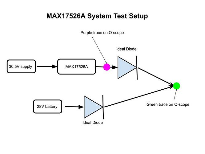

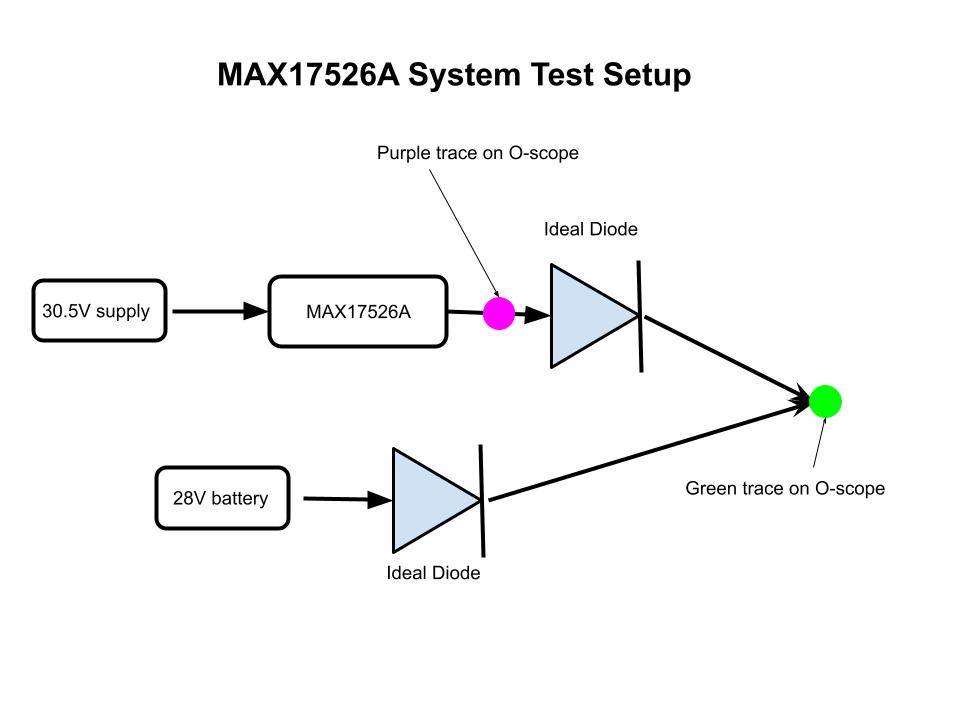

I was able to calculate ~5.5A with the I(in-out) equation, which was a good confirmation that the system is working as expected. The /FAULT line would go low when Vseti was ~1.5V, which equates to close to 5.5A. I also included a block diagram of the test setup.
Yellow trace = /FAULT on MAX17526A
Blue trace = Vseti on MAX17526A
Purple trace = output of current limiter
Green trace = output of ideal diode IC, which is after the current limiter IC

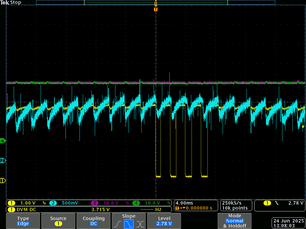

Then later in our testing the MAX17526A reached the thermal shutdown point as can be seen in the plot below. The part appeared to be oscillating in this thermal shutdown state, which is something we are working to prevent but reducing the current draw as well as increasing heat sinking.
So, I now have a much better understanding of the MAX17526A part’s behavior during current limiting. We need to improve the heat sinking for the part as well as try and reduce the current draw.
