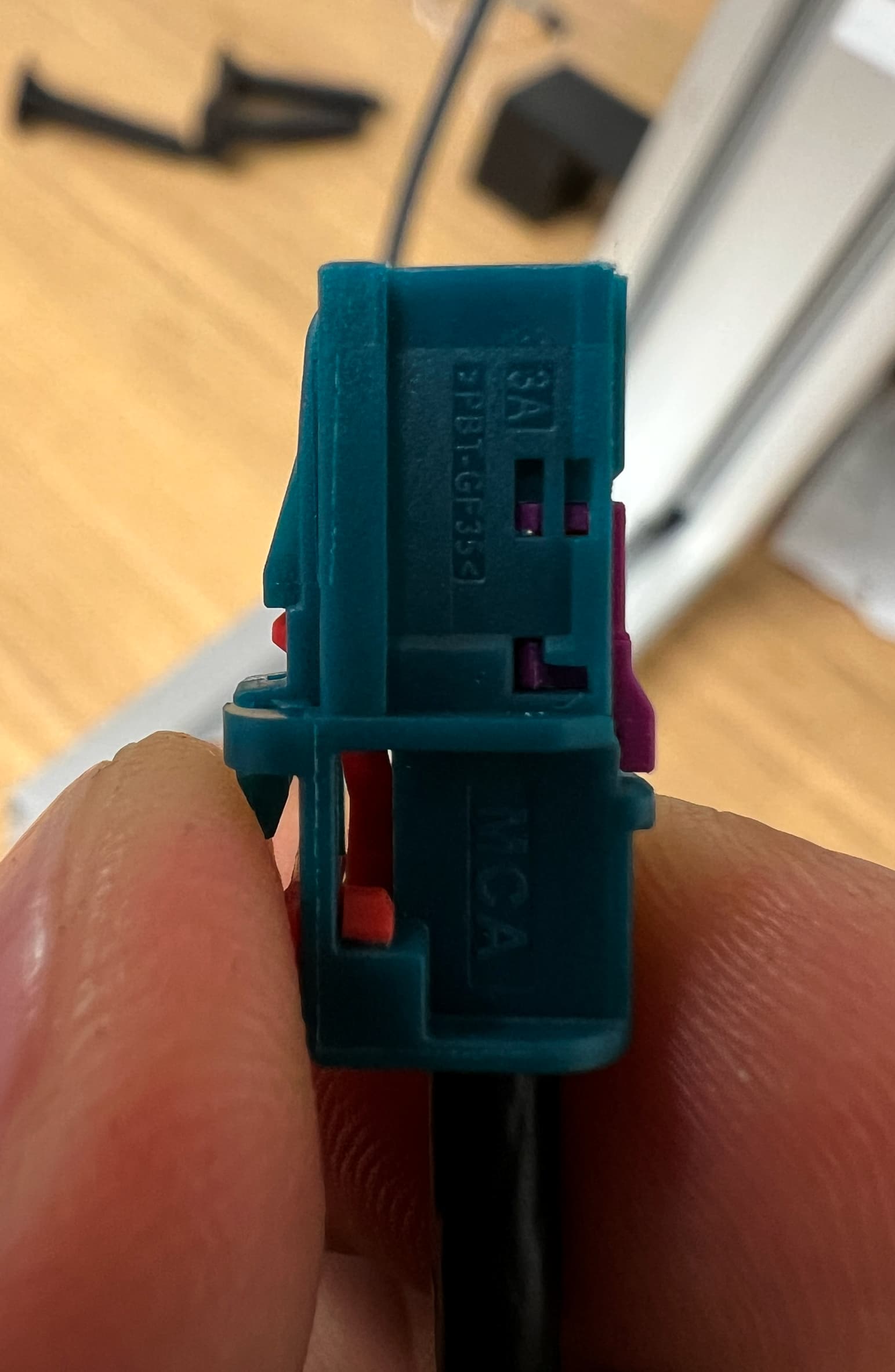

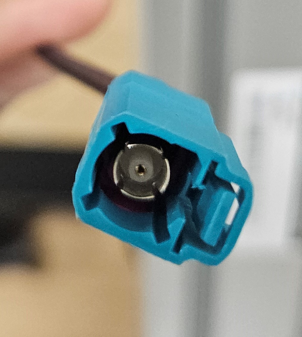

We are in need of the FAKRA Cable Connector for CAR front Windshield camera ,
please find the port pin PIC as shown below .
Help is selecting the right part ASAP

Thank you for contacting DigiKey , The pictures you uploaded did not come through in the post , please try to reattach them so we can see if we have the connector you are looking for .
Thanks Craig
Am I seeing this correctly, do you have three different connectors you’re seeking matches to?
Could you please provide the front view of all three? Fakra connectors can come keyed with notches in different places so it’s critical to get an idea of the keying.
Otherwise, are these two connectors that are mates to each other?
Yes these Connectors are the mates to each other.
Do we have the part available like showed in images.
