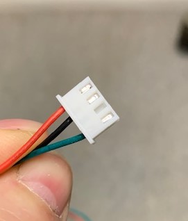

What connector is this? It is 4.0mm x 10.72mm x 8.10 mm Thank you!

Can you measure the spacing between the first and last contact?
With this, we can divide by 3 and get the pitch of the connector, which is essential to identify it.
7.93 mm is the dimension measured between the first and last contact.
7.93 / 3 = 2.64
Please advise how to proceed. Thank you!

We do not have any 2.64mm pitch the closes is 2.54mm , Click here
Found it! thank you for the assistance. It is DK PN: 455-2267-ND and the XHP-4 connector. Unfortunately out of stock!
The Adam Tech 25CH-B-04 is a clone of the JST part, so that should work as well. The associated contact is the 25CTB-R.

thank you for the information
