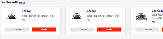

In reviewing the 3M particulate filters, some part numbers that come to mind are 3M162512-ND (2091), 3M158630-ND (2096), and 3M162513-ND (2097). These are typically used with a product like the 3M 6200 half face respirator, but there are various other respirator masks that these can be used with as well. We typically will list the recommended masks in the For Use With area when looking through the product’s page:
- Note: Example from 2097’s product page
