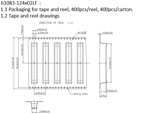

If you are looking for the Packaging (tape and reel) specifications (width and pitch in mm) and orientation for the Amphenol ICC (FCI) 61083-124402LF connector,
Please find the attached packaging specification document for your reference.
61083-124x02LF packaging information.pptx (858.3 KB)
