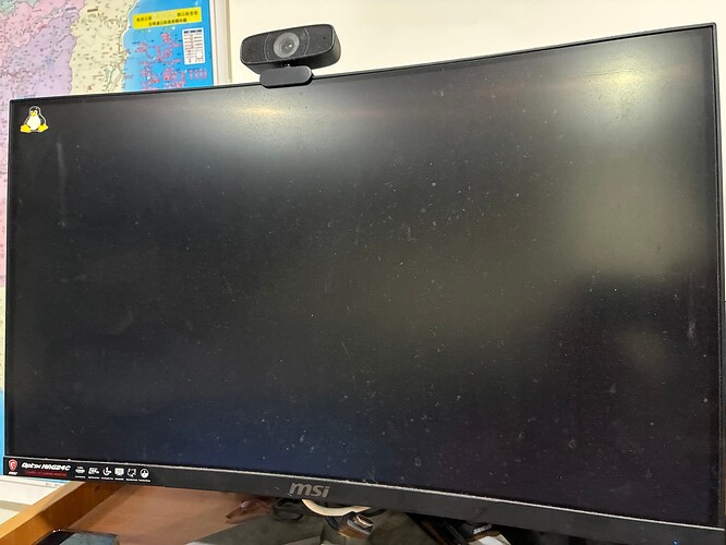

By the way, I had a trial on enabling vlc with extra dependencies, i.e. qt5base and qt5svg, that you’d mentioned here; blank screen without cursor is still shown on my HDMI monitor, even I launched vlc on the terminal of serial console (might be an incorrect manipulation of mine). You may check the picture and log in attached.
I’ll get back once I have more thought. Thanks.
ubuntu-24-04-minicom-bbb-2025-08-06-v1.txt (18.3 KB)
Thanks for the photo, yes, so all we have is the kernel boot logo.. So there is nothing running to grab the screen.. Normally X11/wayland or qt5’s eglfs would have taken over…
Yeap, i guess we can only consider buildroot’s beaglebone_qt5_defconfig a basic starting point, no gui application is loaded by default..

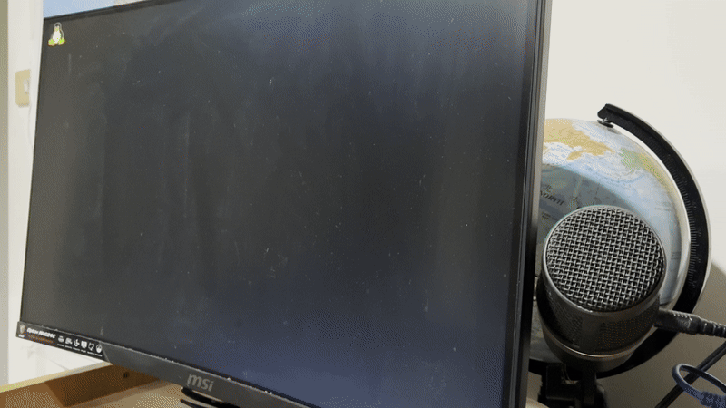

After checked several sites, I’d confirmed beaglebone_qt5_defconfig is okay to display graphic; extra configuration is not needed during compilation time, but extra configuration is needed during run time; refer to readme.txt, it mentioned that:
export QT_QPA_EGLFS_KMS_CONFIG=/etc/qt5/eglfs_kms_cfg.json
export QT_QPA_PLATFORM=eglfs
export QT_QPA_EGLFS_INTEGRATION=none
/usr/lib/qt/examples/opengl/hellowindow/hellowindow
Once the compiled image is programmed into SD card and inserted into BBB, when the graphical program is launched, the graphic is shown on my HDMI monitor; here is an example (i.e. hellowindow).
ezgif-buildroot2-bbb-qt5-2025-10-14-v1
By the way, it seems like that neither toolkit/window manager/desktop environment nor wayland/Xorg is involved in beaglebone_qt5_defconfig.
