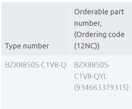

I recently received an order placed for MPN BZX8850S-C1V8-QYL, but phisically it was labebled as BZX8850S-C1V8-Q, without the last “YL”, could you please confirm what the “YL” stands for?
BZX8850S-C1V8-QYL is the orderable part number for BZX8850S-C1V8-Q
Officially the YL is the packaging that part comes on, here is their documentation for it:
DFN1006BD-2; Reel pack for SMD, 7"; Q1/T1-Q2/T3 product orientation
