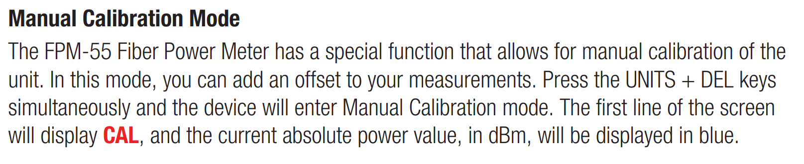

We are often asked for calibration certificates for the FPM-55 power meter from Jonard Tools. We cannot provide them here at DigiKey, you would need to contact the manufacturer. However the Instruction manual does indicate the pre-calibrated wavelengths and the device can be manually calibrated (seen below).
