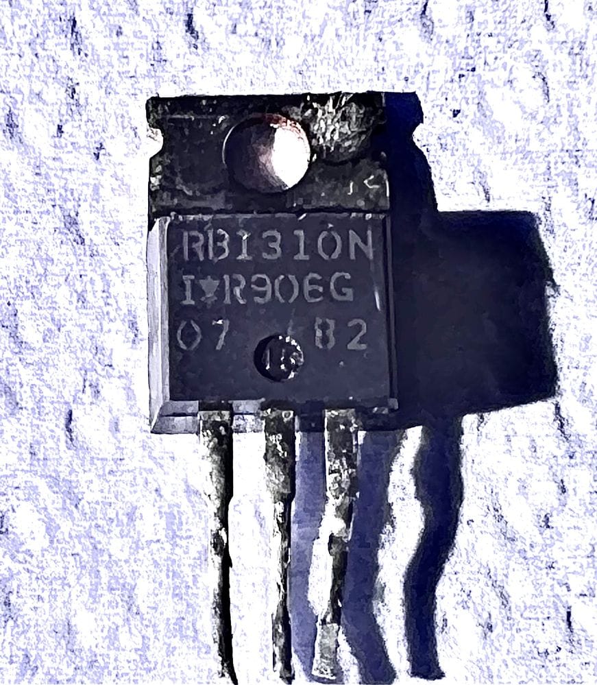

Can't find replacement RB1310N
Hi,
Welcome to the DigiKey tech forum. I searched the markings on this part and wasn’t able to find any information on this part to use in finding a replacement.
With a date code of 2009, 6th week… I wonder if this is just an old version of the current IRFI1310NPBF, same old International Rectifier logo…
Regards,
Thank you for help
