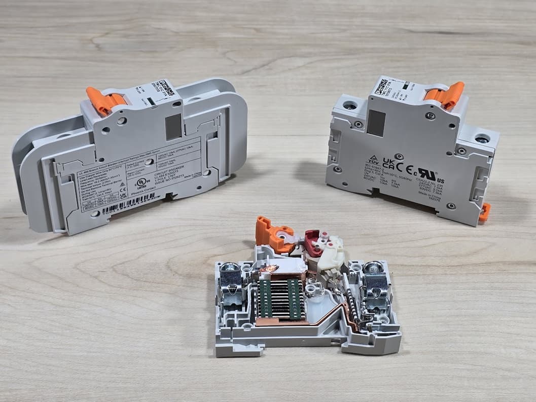

This engineering brief explores the difference between the UL listed circuit breaker and the supplementary protector. Representative examples are shown in Figure 1 including:
  • Left: Phoenix Contact TMC 81A 01A which is a UL 489 listed circuit breaker
  • Right: Phoenix Contact TMC 71C 01A which is a UL 1077 supplementary protector
    Note that a partially disassembled TMC 71C 01A is shown in the foreground.
Figure 1 Phoenix Contact 2907558 circuit breaker (left) alongside a 1019972 supplementary protector (right). A partially disassembled 1019972 is shown in the foreground.
Tech Tip: Many manufacturers follow this same pattern for UL 489 and UL 1077. For example, we could have explored the Siemens 5SJ and 5SY series with similar results.

UL 1077 interrupters are not suitable for branch protection.
Referring back to Figure 1, we see that the TMC 71C and TMC 81C are similar. However, one is UL 489 listed and the other is UL 1077. While the TMC 81C in Figure 1 is rated for 10 kA SCCR at 277 VAC, the TMC 71C is rated for 0.2 kA according to UL 508A Table SB4.1. Installing the incorrect circuit breaker could compromise the panel’s SCCR. It will also compromise the MTR’s reputation when the UL inspector finds the discrepancy. It could also compromise the panel shop’s reputation as the panel would require rework or face loss of UL listing.

The Phoenix Contact 2907558 is shown in Figure 2. Here we see a prominent UL circle along with the word LISTED. The UL 489 appears as the very first word in the label. While it’s subtle, the UL file number E320373 also appears. This number points to an official, highly detailed document describing the test conditions for the circuit breaker. It also allows us to quickly find the information in UL’s Product iQ.
On a related note, Figure 3 shows the UL recognized marking (backward UR symbol) for the Phoenix Contact 1019972 supplementary protector.
Figure 2: Image of the Phoenix Contact 2907558 circuit breaker showing the UL E320373 Listing.
Figure 3: Image of the Phoenix Contact 1019972 supplementary protector with the UL Recognized Component Mark.
