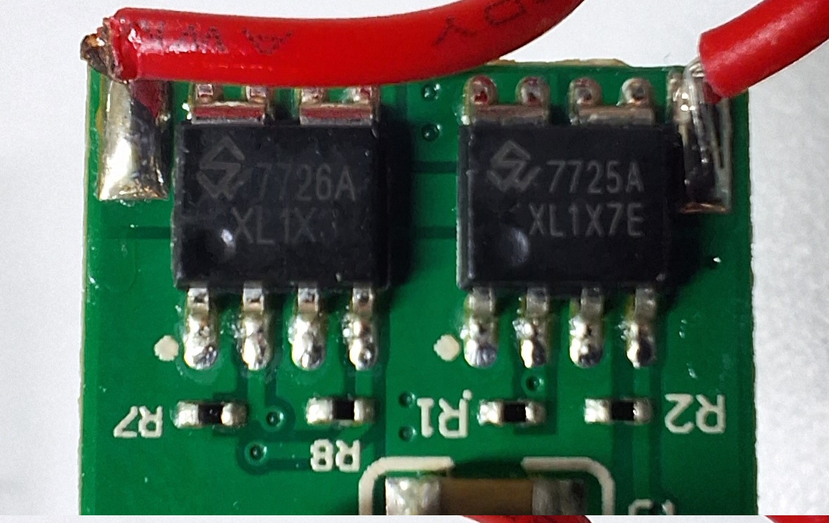

Could someone help me identify this IC?
Hi! I am trying to identify the component on the image but without success until now. It is part of a servo controller circuit board, there are two ICs like the one in the first image positioned on the board. Apparently, they are intended to work on the same way.
It is:
20V Dual P and N - Channel Enhancement-Mode MOSFET SWK7726A, SWK7725A
SWK7725A.pdf (247,8 КБ)
SWK7726A.pdf (230,9 КБ)
Welcome to the DigiKey TechForum. Adam7 may be have ID’d these chips . I searched the numbers and they are not listed on our system. I’m not able to open the datasheet links provided or find them in a search. Without the specifications I’m not able to check for possible alternates.
