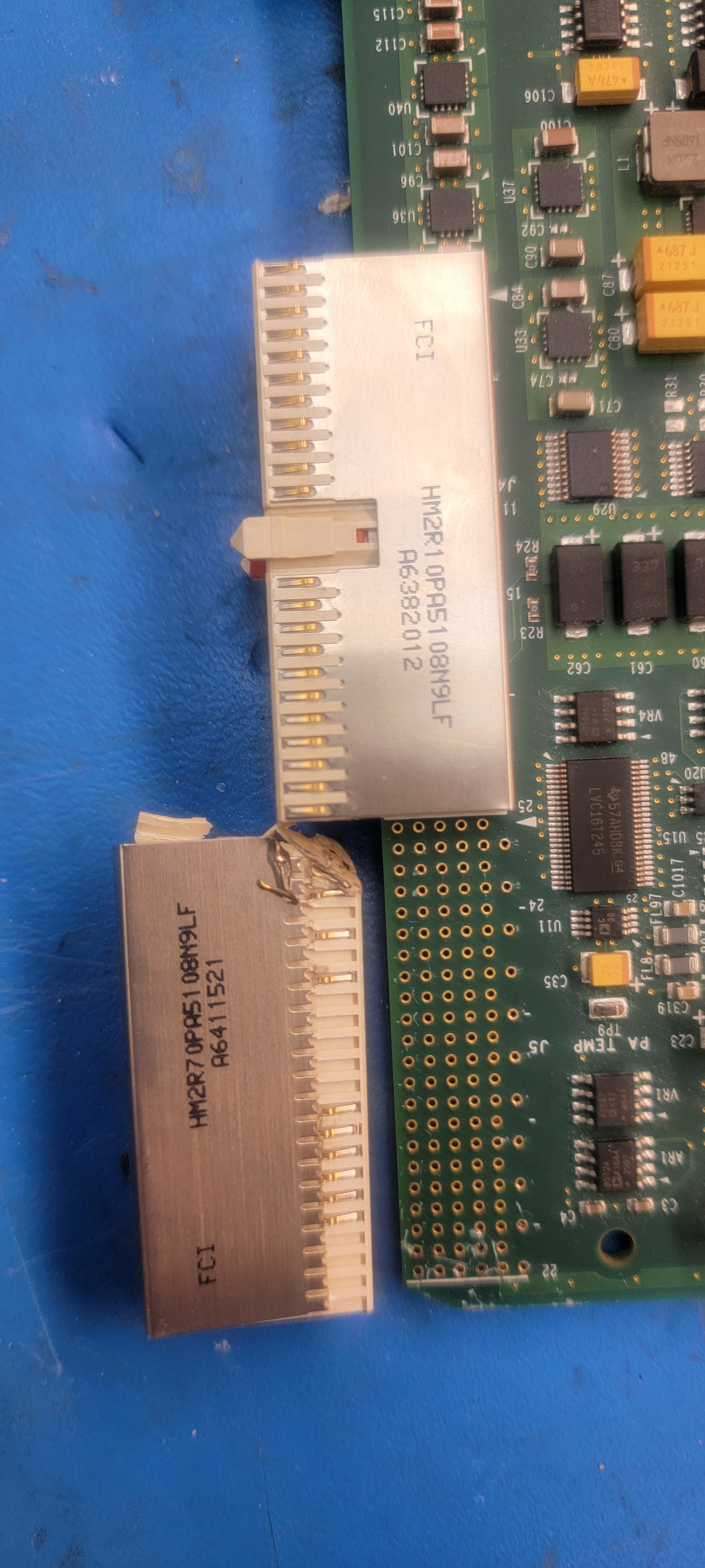

I found the part I need but can someone help me find the right Crimpers or Press I need for the part?

They don’t list any tooling on the datasheet, but they do list that Application tooling is available on request. Would you like me to contact the supplier to see what they have?

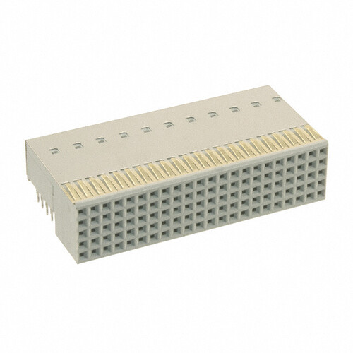

this is also compatible right? and if so do you guys have the tool for this?
I found the 17 99 000 0036. the drawing for this shows that is would be for the type B 22 size.
And their description says it is for angled female connectors.
17990000036_100074959DRW003A.pdf (25.1 KB)
Thank you. Looking into it
Per supplier -
Please refer to page 9 Application tooling for HM2R70PA5108N9LF
