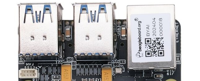

Is there a way to access the debug port on the AM67 chip? Perhaps via JTAG on the Tag Connect connector? Where is this? I don’t see it on the board diagram so perhaps it is on the back?
Debug uart uses on this uses a Raspberry PI Debug Probe style serial cable:
Jtag is available between USB headers:
