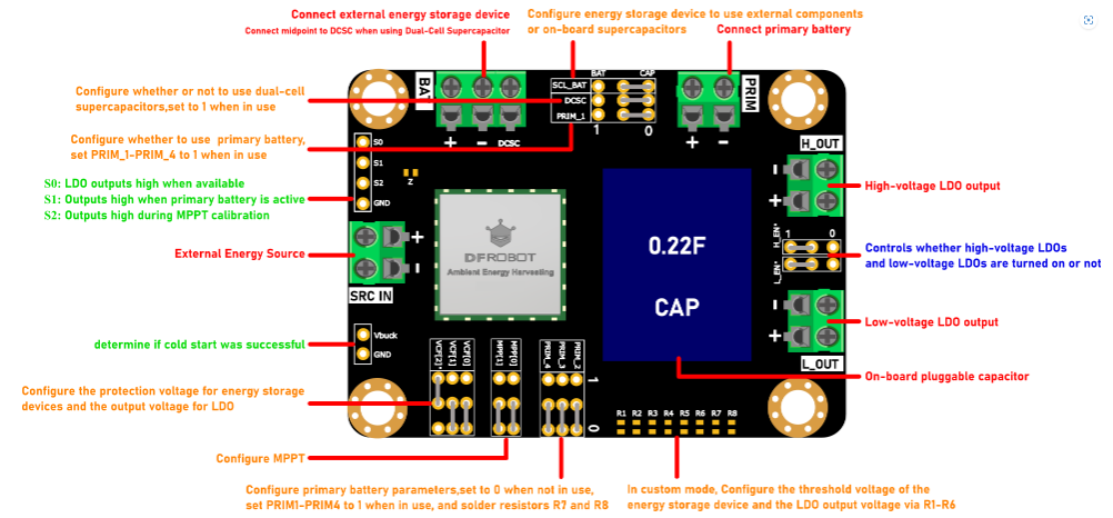

Board Overview
1. What You Need
Before getting started, make sure you have the following items ready:
  • DFM8001 Energy Harvesting Module Evaluation Board x 1
  • 0.22F Supercapacitor (included in the kit) x 1
  • Amorphous silicon photovoltaic panel (included in the kit) x 1
  • Multimeter/1.8V low-power load

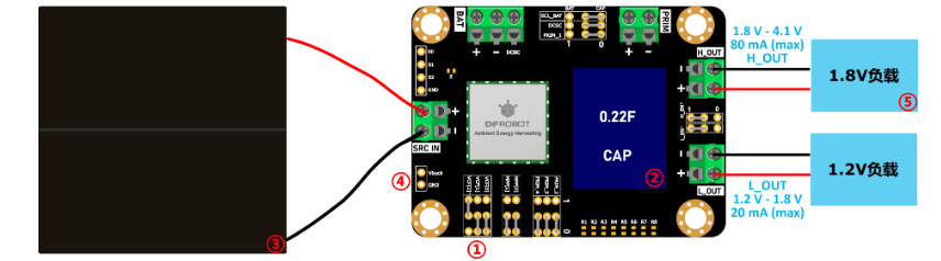

2. Physical Setup
Step 1: Insert the 0.22F Supercapacitor
  • Install the 0.22F super capacitor onto the board.
    Before fully understanding all configurations, use the new 0.22F super capacitor provided in the kit. When using pre-charged capacitors or batteries, ensure the initial voltage of the capacitor is less than Voc.
Step 2: Connect the Amorphous Silicon Photovoltaic Panel
  • Connect the amorphous silicon photovoltaic panel and ensure the front side of the panel is exposed to light.
  • When connecting, pay attention and ensure the terminals of the evaluation board are in full contact with the metal part of the PV panel leads. Pressing in too much of the wire’s insulating jacket may cause connection failure.
3. Jumper Configuration
The jumper cap configurations are important to ensure that the module operates correctly. Initially, all jumper caps are in the default state. Here’s how to set them up:
  • SCL_BAT: Set to CAP
  • L_EN and H_EN: Set both to 1
  • VCF[2]: Set to 1
  • The remaining jumper caps should be set to 0.
Do not adjust jumper cap configurations without fully understanding all the module’s settings, as this risks damage to the device.
Connection Diagram
