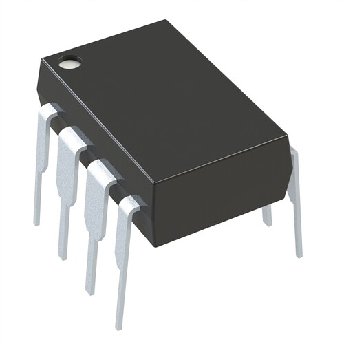

To get started I recommend you breadboard a few experiments using the PIC10F200-E/P DIP version:
On a personal note, I’ve always appreciated that fact the Microchip provided DIP sockets version of the chip.

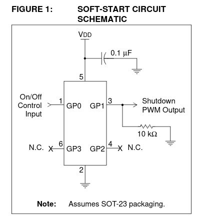

This is a small 2.0V to 5.5V based 8-bit micro-controller. How to plan to interface to your “lamps” are these powered/controlled by the AC mains (AC 120 US, etc..).. Or some sort of PWM lamp?
Microchip has a pretty good ‘on’ / ‘off’ example here: https://www.microchip.com/en-us/application-notes/tb081
So, how do you control the ‘lamp’? In 99.9% of the cases you will not be directly wiring this device to your lamp… Something will be in between..
