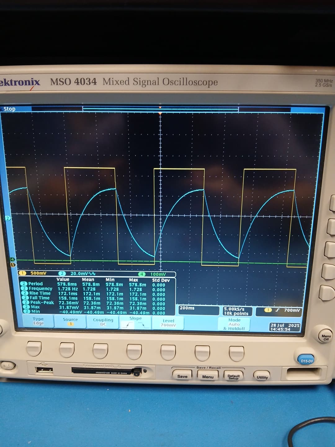

Nice kit, the assembly instructions are quite clear. I have included some measurements on this post related to this circuit for anyone interested.

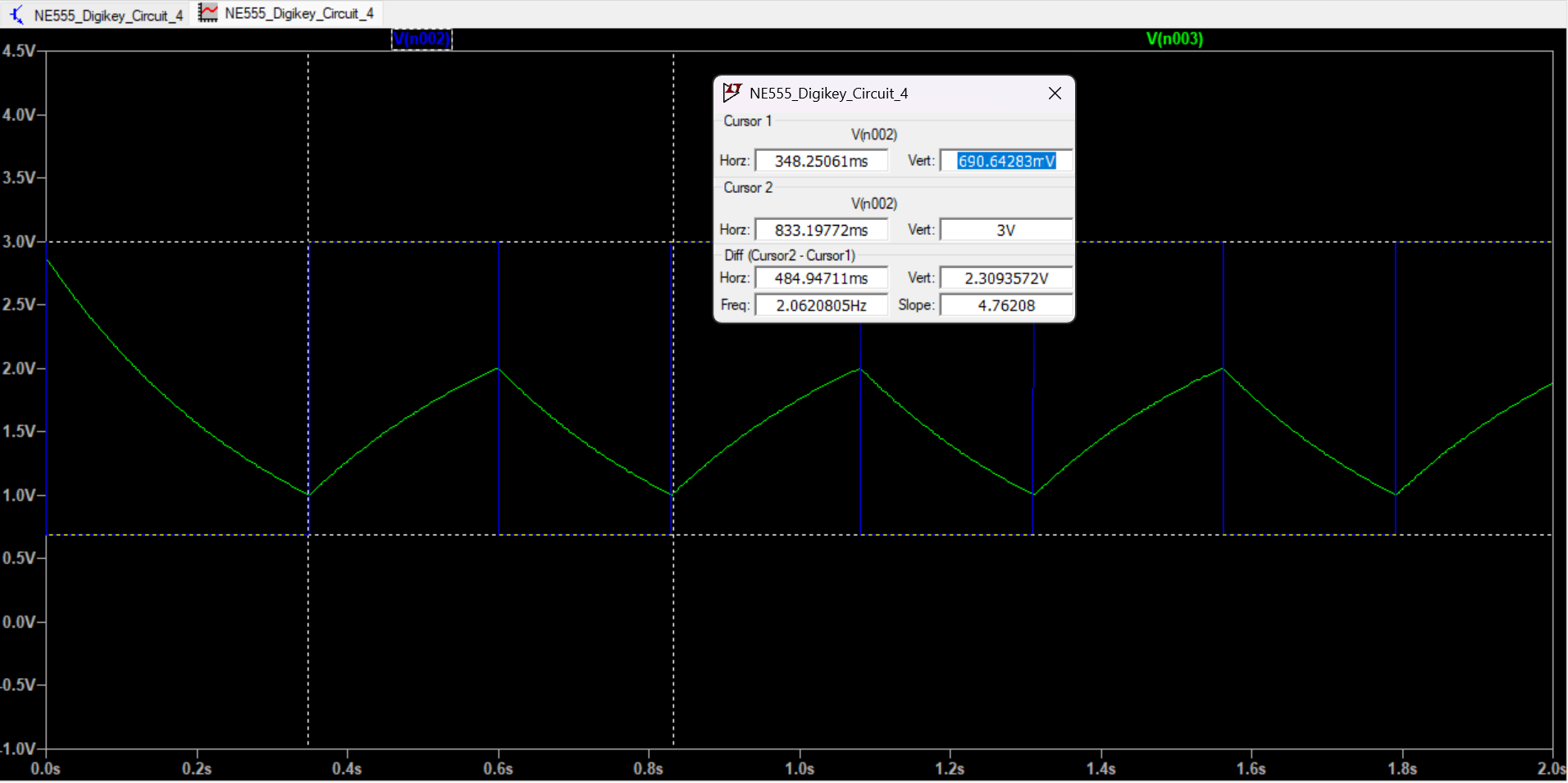

Also here is a LTSpice simulation of this circuit, the following plot shows the output voltage and current thru the Light Emitting Diodes (LED) alternating in the sequence,

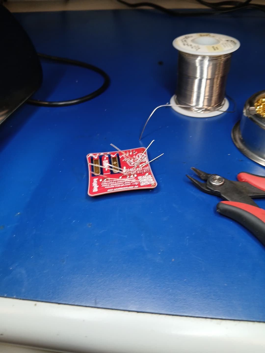

Is there a troubleshooting guide for soldering newbs? I have it all soldered but only 1 led lights up, is there a way to find a cold solder with a multimeter? What soldering iron and solder are you using to make it look so easy?
fred3,
We do not have a troubleshooting guide, but you can search the internet for help.
You can use the resistance setting on the multimeter to check if a solder connector is a direct connection. Touch the leads of the meter together, and that’s the reading you should get with a good solder connection. If you get a high resistance reading, then you should resolder that connection. I don’t know what equipment they used, but if you use solder which contains lead, it will melt quicker and flow easier. If the solder has a flux core, that will help also.
If the LED is flashing, then the problem would be with the other LED. If it just stays on solid, the problem may be with the connections to the IC. Good luck with the project.
