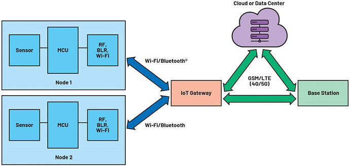

Figure 1. The typical building blocks of an IoT system.
When selecting protection components, we should consider the development trend of future technologies, especially the requirements of 5G and IoT, and ensure that the network components we use can meet the requirements of future applications. Here are some factors to consider:
