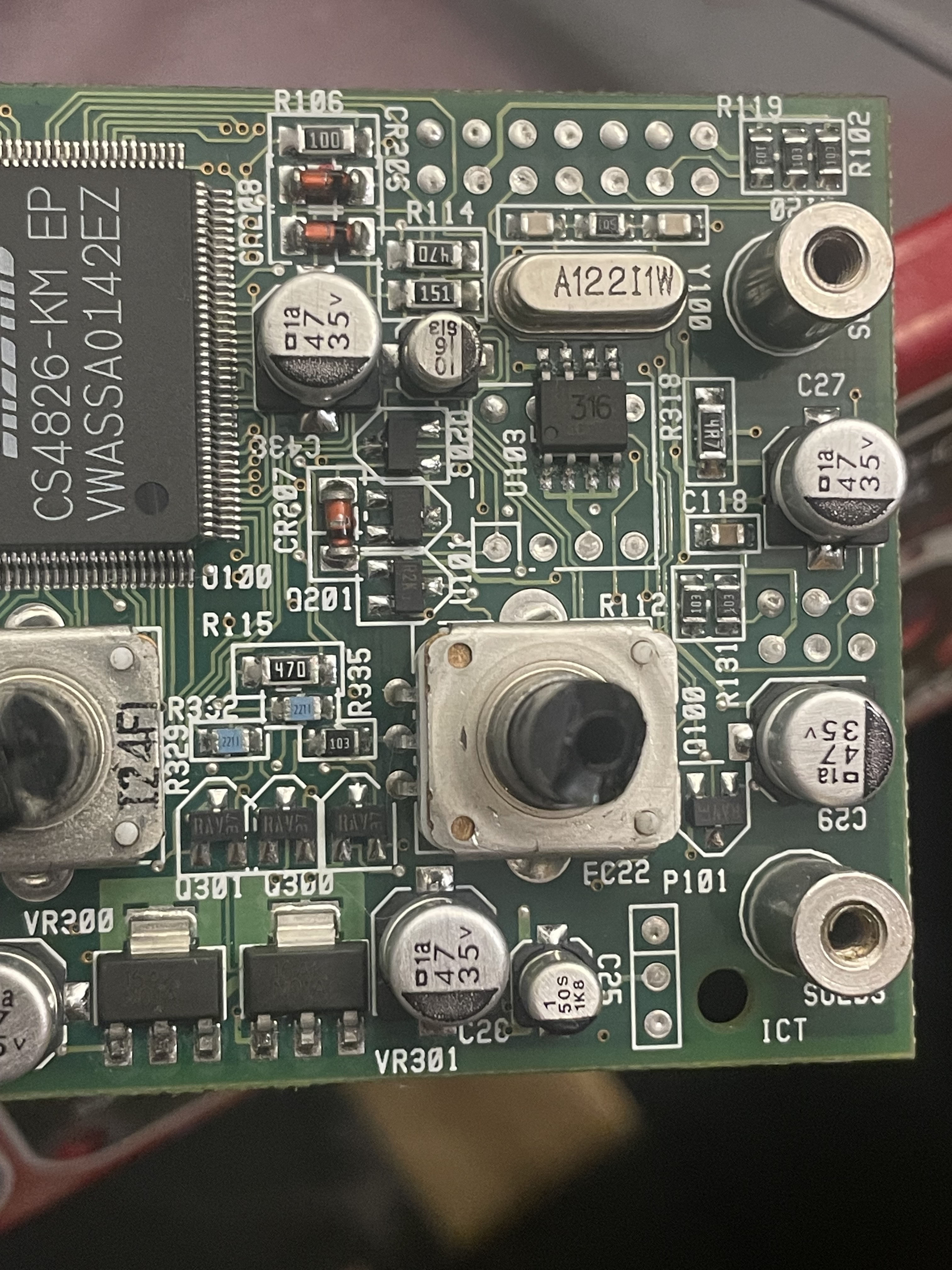

Encoder ID
I’m trying to ID this encoder so I can replace it. It’s currently in a Peavey Transtube 212 guitar amp. The only identifying markings on it are “24F26J”. The encoder is mechanical, and has a push button switch. It measures approx 12.5mm x 13.4 mm with a 30mm long shaft. It solders directly onto the PCB with 2 pins on one side and 3 on the other. Pictures are below. This encoder cycles through settings and changes modes on the amp. I believe this is the correct part (link below) but would like opinions. Thank you.
Welcome to the Digikey tech forum. Looking at the datasheet for part PEC12R-4230F-S0024 the description you provided does match but I wasn’t able to find any information on the current part you have to compare and verify these are the same.
It was a direct replacement and works just as it should.
Awesome, glad it worked out for you!
