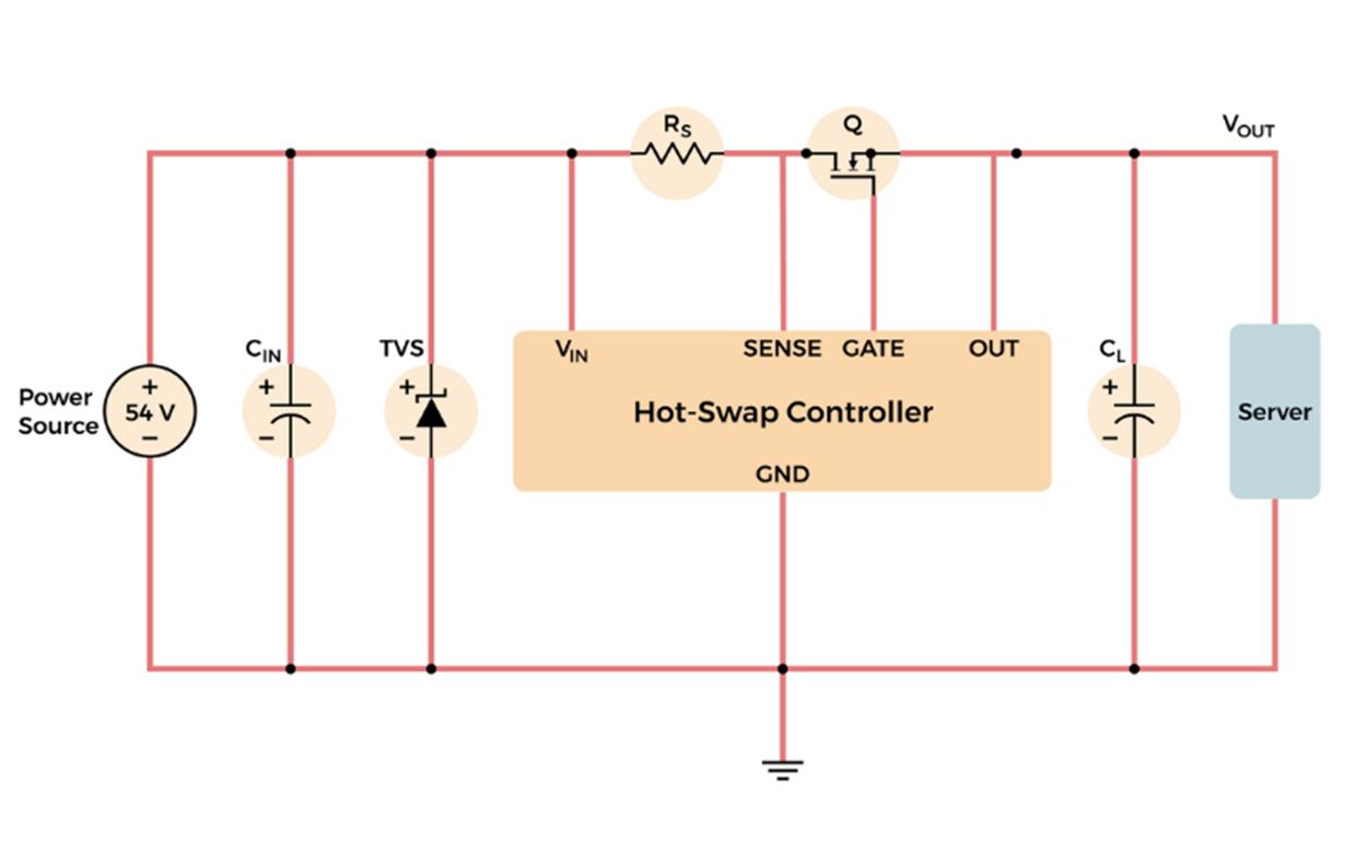

Data center circuits are highly complex. However, when analyzing the power supply architecture, the block diagram can be simplified for clarity, as shown in Figure 1.
Fig. 1. Block diagram 54V DC-based power supply architecture.

To manage capacitive in-rush currents, hot-swap circuits control current peaks that could damage connected servers during board swapping.
These circuits, as seen in Figure 1, safely disconnect a failed server by turning off MOSFET Q1 to avoid overcurrent damage in case of a failed load.
Still, having a proper hot-swap design will not prevent parasitic inductances from the backplane to the swap card connection to cause an inductive kickback when a faulty load is disconnected. This phenomenon occurs because the overcurrent detected by the hot-swap controller will still try to flow during load disconnection, leading to arcing risk.
To prevent damage, this overvoltage must be diverted from the circuit and discharged safely. This is why TVS diodes are indispensable. The TVS diodes must be connected in parallel with the power supply to provide adequate protection during inductive overvoltage transients. These clamping diodes will protect the system by limiting the voltage using the avalanche effect.
