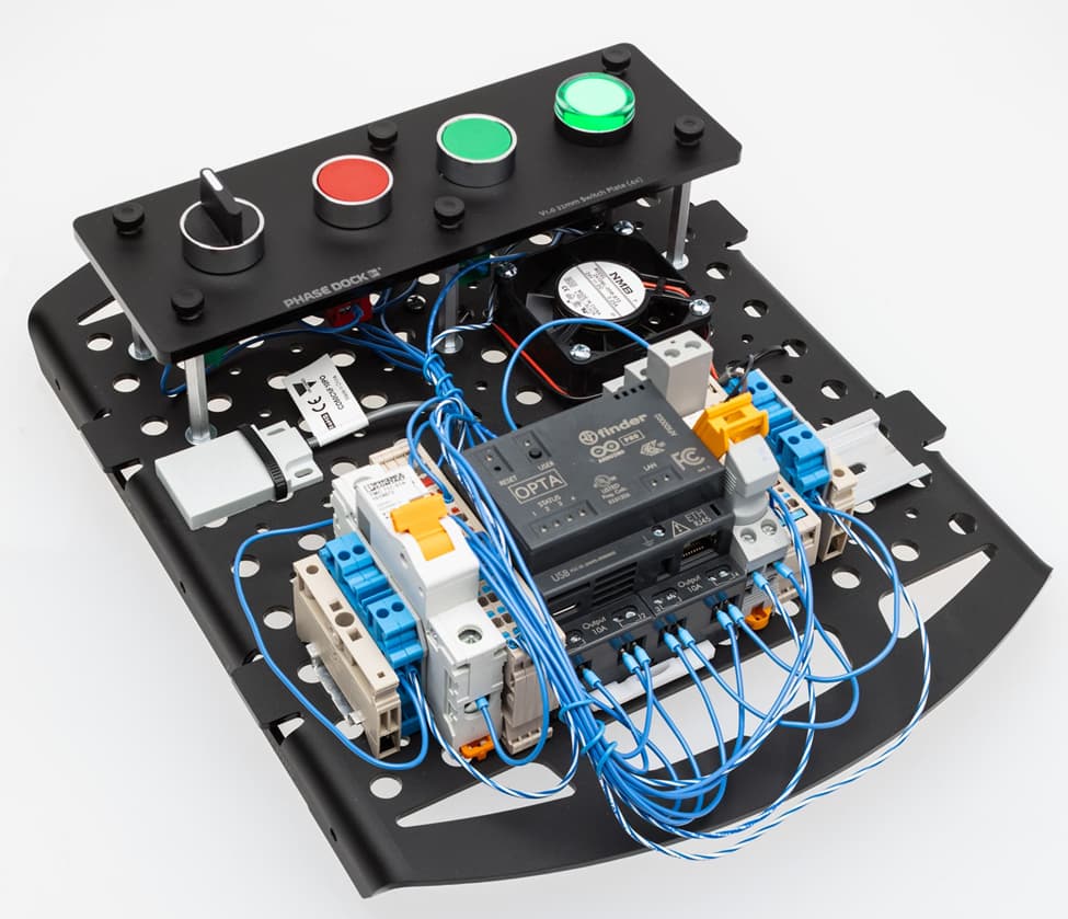

One solution is the Phase Dock trainer as shown in Figure 1.
Let’s explore the history of this design.
Figure 1: Image of the Phase Dock trainer with supporting hardware (sold separately).

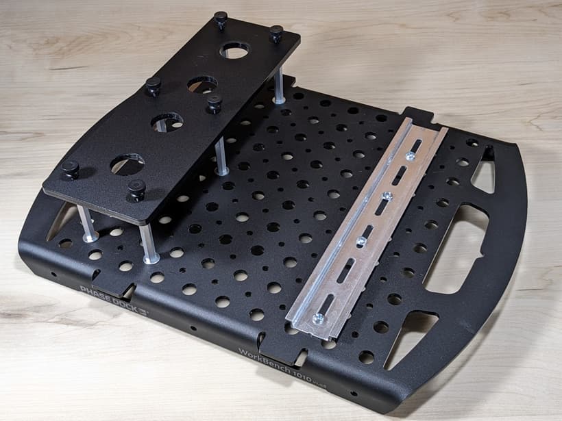

The original designs were based on Phase Dock 10-10 platform that was readily available in the DigiKey lab. These platforms were designed for students as a rigid mounting platform for microcontroller projects. The major selling point is that the wires will remain in place when the student’s project is transported. The robust aspects carry over when a DIN rail is installed on the base.
The switch plate for the 22 mm pushbuttons and panel indicators took longer to develop. I cut the first version out of aluminum. This worked very well, but it didn’t scale, as it takes time to cut and punch the holes. Later, I discovered that DigiKey technicians had untapped talent. A day after the conversation, I had a 3D printed part on my desk. After a week I had the first laser cut switch plate.
At this point, we had our industrial breadboard. We gained experience as it was featured in several TechForum articles. The final step was to return to Phase Dock and request that the switch plate be added to the 10-10 base. Before moving on, I should mention the nylon thumb screws. Originally, I had used screws and was considering adding magnets for quick release of the switch plate. In conversation, one of the partners suggested nylon thumb screw. This was a very good idea as they are inexpensive and add an attractive feature to the trainer.

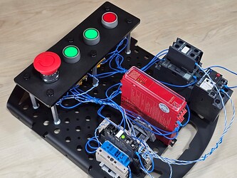

  • A Schneider Electric safety relay is evaluated in Figure 2. The primary focus is the relay-to-emergency stop connection. A secondary focus is the Schneider motor starter and the E-T-A solid-state circuit breaker
  • A Siemens LOGO! PLC is evaluated in Figure 3. The primary focus is the LOGO! PLC with its integral HMI. The 4-position (22 mm) switch plate can accommodate a variety of field devices ranging from pushbuttons to variable resistors, and even ultrasonic sensors.
Figure 2: The trainer is used to evaluate a Schneider safety relay.
