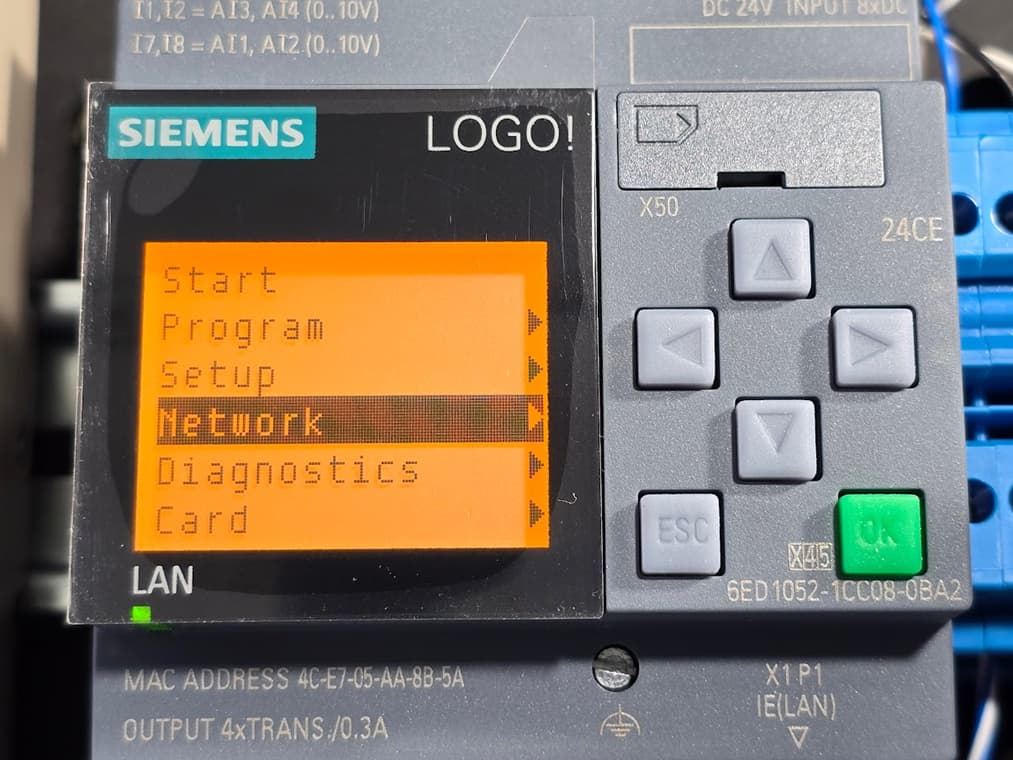

Figure 1: Image of the initial welcome screen of the Siemens LOGO! model 6ED10521CC080BA2.

Connect the LOGO! PLC to a network using a CAT 5 or better cable. Ensure your PC is on the same network. This would be a good time to log into your router and verify the DHCP table. Alternatively, you could ping the default gateway from the command prompt.
Initial Welcome Screen
This is the initial login screen for the LOGO! PLC.
Select Network
Use the arrow keys to select the network field.
Select IP Address
Select the IP Address field.
Observe the default IP address setting
By default, the LOGO! is configured as 192.168.0.3 with a subnet mask of 255.255.255.0.
Configure the LOGO! for your network
In this example, we set the LOGO! to operate with a fixed IP address of 192.168.1.3 and a subnet mask of 255.255.255.0. Adjust as necessary for your network.

Connection verification
The connection may be verified using the PING command:
We can also verify using the connection tools from LOGO! Soft Comfort program. The green bar and checkmark indicate success.
Tech Tip: If PING fails, start by checking for physical cable connectivity between your PC and PLC by looking at the LEDs on the router.
Next, verify that both devices are on the same network e.g., 192.168.1.0. One excellent way to do this is to log into your router. If the PC can talk to the router, you are halfway done, as the problem is isolated to the router to PLC connection.
