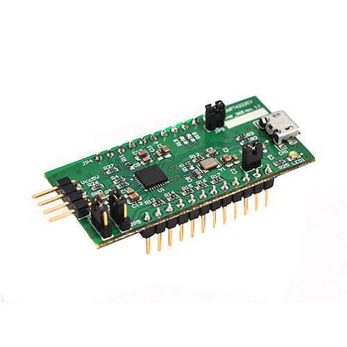

If you’d prefer a solution that does not require microcontroller programming, but you are fine to do some tinkering, you could perhaps use a USB-to-SPI interface card, such as https://www.digikey.com/en/products/detail/ftdi-future-technology-devices-international-ltd/UMFT4222EV-D/8625527
Just tie an IR-receiver diode and a resistor to the MISO input of the board so that the MISO line goes high when having light and low when not (or opposite) and periodically sending a dummy byte from PC (via virtual COM port) to create an 8-bit SPI frame and then read back the response, which will be 0x00, when there is no light and 0xFF (or other non-0x00 value) when there is an enlightenment (or opposite)
