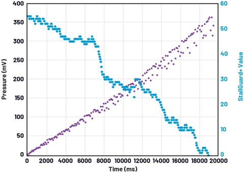

When an occlusion such as a kinked line, clamped tube, or downstream blockage occurs, the resistance to fluid flow increases immediately. This increased resistance manifests as higher mechanical load on the motor, which, in turn, alters the motor’s current draw and electrical operating point. StallGuard+ detects this change directly, enabling the system to recognize abnormal load conditions.
Figure 4 shows that creating an occlusion by clamping the tubing caused the pressure to increase gradually while the StallGuard+ value decreased, showing a clear inverse correlation.
As the blockage worsened, StallGuard+ eventually reached zero, at this point software used the stall indication to stop the motor and trigger an alarm.
Figure 4. StallGuard+ vs. pressure buildup in response to an occlusion.
The strong inverse relationship between pressure and StallGuard+ values confirms that StallGuard+ is an effective sensor-free method for detecting occlusions, especially at low flow rates where conventional pressure-based alarms may respond more slowly. While it is not intended to completely replace pressure sensors, StallGuard+ serves as a valuable complementary diagnostic tool. It can help provide faster initial detection, redundancy for safety monitoring, or diagnostic insight in designs where pressure sensors are constrained by size, cost, or mechanical placement.
