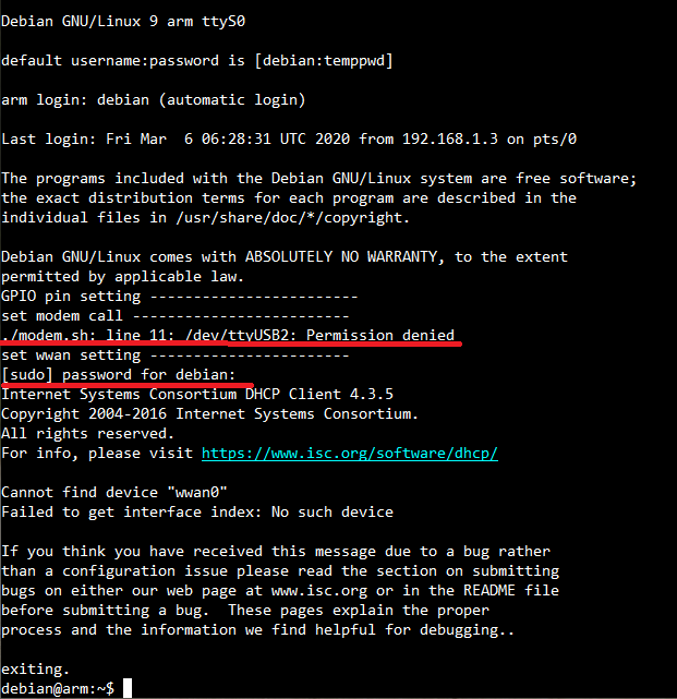

After the Beaglebone is automatically logged in, when the modem.sh is executed, it stops with a message asking for the superuser’s password.
I want to run the shell script (modem.sh) without message asking password
so I want to run the program ( LoraControl ) automatically without any input after the board is powerd on

I edited the file “/etc/sudoers” as follow
but when I powered on the board, the message is displayed as follows.
it have permission denied and ask password.
I don’t know why.
I changed “sudo ./modem.sh” in .bashrc to “./modem.sh”
How can i resolve it.
thank you
@taek8461, remove “, /dev/ttyUSB2” from /etc/sudoers, that is a “device” not an “application”…

Edit, looking at your log, the other sudo password came during:
echo "set wwan setting -----------------------"
sudo dhclient -v wwan0
So, dhclient is using a different path… run: “sudo which dhclient” then update /etc/sudoers with where it’s located on your root file system.

  1. /dev/ttyUSB2 has been a permission denied.
  2. dhclient request password.
    the path is /sbin/dhclient
I don’t know what’s wrong.

Hi
Thank you for your response
When I tried to run an app (including sudo) on prompt, it didnot ask the password.
but when powered on and run automatically, it asked the password
How can I resolve it?
Regards.
@taek8461, okay not sure what’s causing that. So enough with the random hacks, and let’s do things the right way for a systemd based system in 2020.

Hi.
I resolved it.
Thank you so much.
