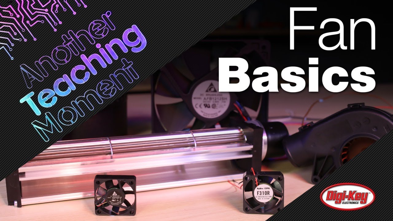

Here’s a video take on the topic if you would like to check it out.
