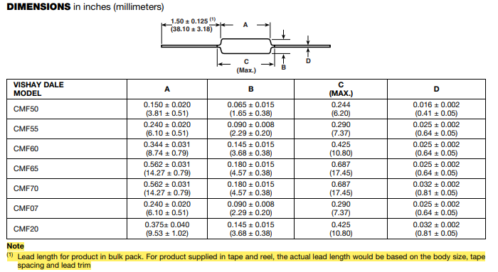

If you have any doubts about the lead length of CMF (Military RN and RL) Through-Hole Resistors from Vishay Dale, please note the following:
The standard lead length of 38.10 ± 3.18 mm applies to parts supplied in bulk packaging (part numbers with B14 or BSL).
These are Through-Hole Resistors in bulk packaging. Through Hole Resistors -
For products supplied in tape-and-reel packaging, the actual lead length depends on the body size, tape spacing, and lead trim.
This means that part numbers with “R36”, “RE6”, and “RSL” are pre-trimmed to fit the tape-and-reel format, resulting in shorter leads than the bulk specification.
These are Through-Hole Resistors in tape-and-reel packaging. Through Hole Resistors
