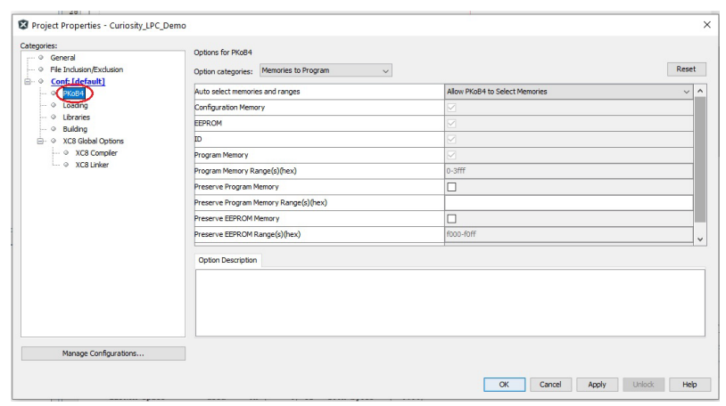

Access Project Properties:
- Click the “Project Properties” icon in the project dashboard window (as shown in Figure 2-1).
- Alternatively, navigate via
File > Project Propertiesor right-click the project name in the “Projects” window and select “Properties”.

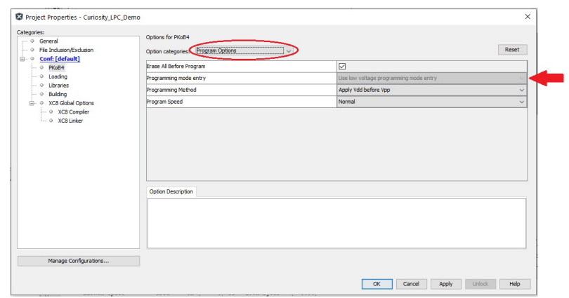

Note: The Curiosity LPC board must be programmed using Low-Voltage Programming (LVP). The LVP bit in the configuration words must be set to enabled (LVP = ON or ‘1’).

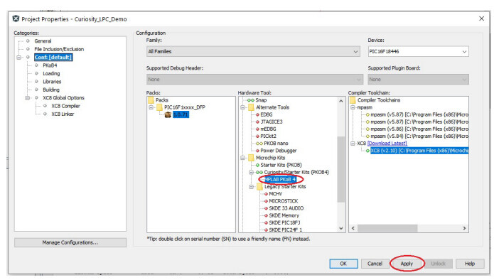

- Configure the Programming Tool:
- In the “Project Properties” window, select the programming tool, compiler, and PIC MCU.
- MPLAB X IDE identifies the Curiosity LPC board as “Starter Kits” in the “Hardware Tools” selection window.
- Set PKOB Programming Options:
- Click “Starter Kits (PKOB)” in the upper-left corner to reveal the PKOB programmer’s configuration options.
- Enable Low-Voltage Programming Mode:
- Select “Program Options” from the “Category” dropdown menu.
- Ensure “Programming mode entry” is set to Low-Voltage Programming. The board is now ready for programming.
7 Compile and Program the Device:
- Click the “Make and Program Device” button. MPLAB X IDE will compile the code and flash the program to the PIC device.
