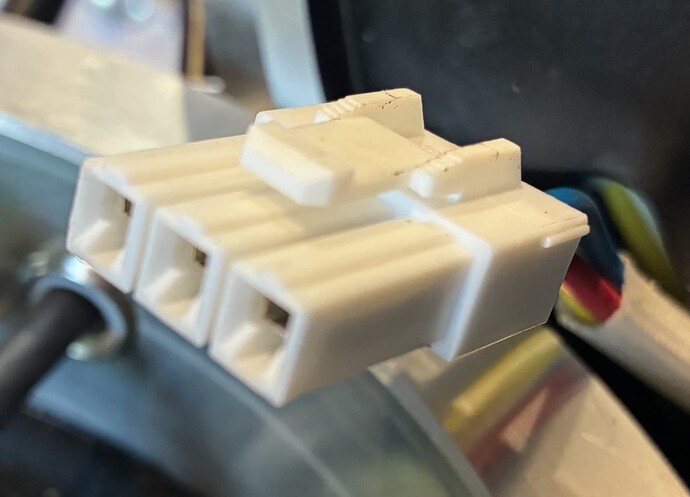

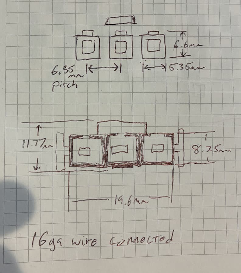

Hi, I’d appreciate help in identifying these motor connectors. They are used to supply power from a motor drive to the motor with 16 gage wire. I’ve attached pictures below of the connectors themselves as well as a dimensional drawing.
Thanks!

Hello tv123,
The closest matches I found, have a 6.20mm pitch for the pin spacing.
Click here for 455-2356-ND and Click here for 455-2350-ND.
The male contacts for 16awg wire are 455-2348-1-ND and 455-2379-1-ND.
The female contacts for 16awg wire are 455-2347-1-ND and 455-2376-1-ND.
Please check the datasheets to verify compatibility to your application.
Thank you! That looks like just what I need!
