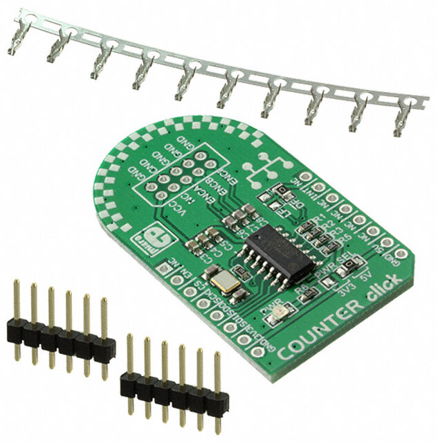

Is there any quadrature counter board with multiple LS7366R? I need to control 12 servomotors and don’t want to design a PCB at this moment.
Hi RubenMechie,
Welcome to the DigiKey TeckForum.
I couldn’t find any boards with multiple LS7366R’s on board. The only one I could find is the MIKROE-1917, which contains only a single LS7366R.
One could conceivably hack something together with multiples of these boards without mounting them on a baseboard, though I would be worried about electrical and physical integrity for more than just proof-of-concept usage. Though you would prefer not to, I suspect that a baseboard PCB made for for multiples of these boards would be relatively simple to design and get produced.

Thanks for the suggestion. I may have to make it work using a secondary microcontroller to offload the counting (until I find another board with at least four LS7366Rs or design it myself). There is one from superdroidrobots, but too bad it’s not carried by DigiKey.
I can see why the LS7366 is an appealing part, as it takes care of handling the quadrature input, the counting, and the SPI output. It offloads quite a bit of potential code.
It would be challenging to implement 8 separate quadrature counters by muxing a bunch of I/O’s together and keeping track of the count on each inside a single MCU. It looks like that part is quite possibly just a pre-programmed MCU that acts as an interface between an encoder and the master MCU.
Nope, I was not able to find any board we carry with more than the single device on it.
