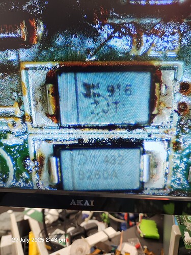

Plz help i need to buy this smd and i can't find it
Is the 916 zjt

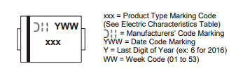

It looks like it may be SMAZ39-FDICT-ND. Looking at the screen shots below, the markings for this device do appear to make sense for your product.
Page two of the datasheet does provide the Product Type Marking Code, SMAZ39 is listed as being ZJT.
