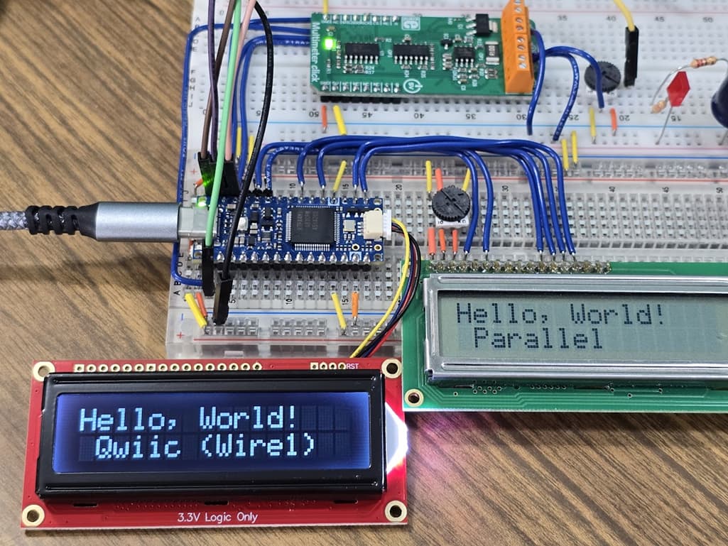

Figure 1 presents two methods including the traditional parallel interface as well as the Qwiic connection.
Parallel: Hundreds of articles have been written about the traditional parallel interface. To learn more about this technique (blue wires in Figure 1) refer to this Liquid Crystal Displays (LCD) with Arduino.
Serial: The serial interface is preferred over parallel as it reduces the number of required wires. A recent addition to Arduino is the user-friendly Qwiic (I2C serial) connection. The SparkFun 16397 LCD featured in Figure 1 requires only 4 physical wires. For a brief introduction to Qwiic, refer to this article. It describes Qwiic as convenient but limited in speed and distance. This may or may not be a problem for your application.
Figure 1: Author’s workbench showing the Arduino Nano R4 connected to both a Qwiic LCD and a Parallel connected LCD.
