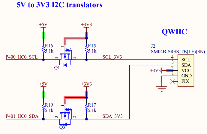

The Arduino UNO R4 WiFi and the Arduino Nano R4 provide 3.3 VDC for the Qwiic.
  • The RA4M1 microcontroller operates at 5 VDC.
  • Level shifters are used to interface the microcontroller to the Qwiic devices. Figure 1 presents the circuit for the Arduino Nano R4.
  • The Qwiic power pin is derived from a 3.3 VDC regulator.
Figure 1: Schematic diagram for the Arduino Nano R4 Qwiic circuitry showing 3.3 VDC level shifters.
