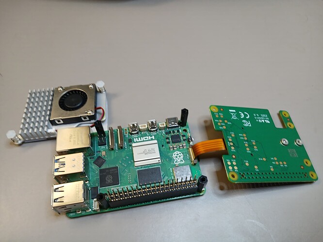

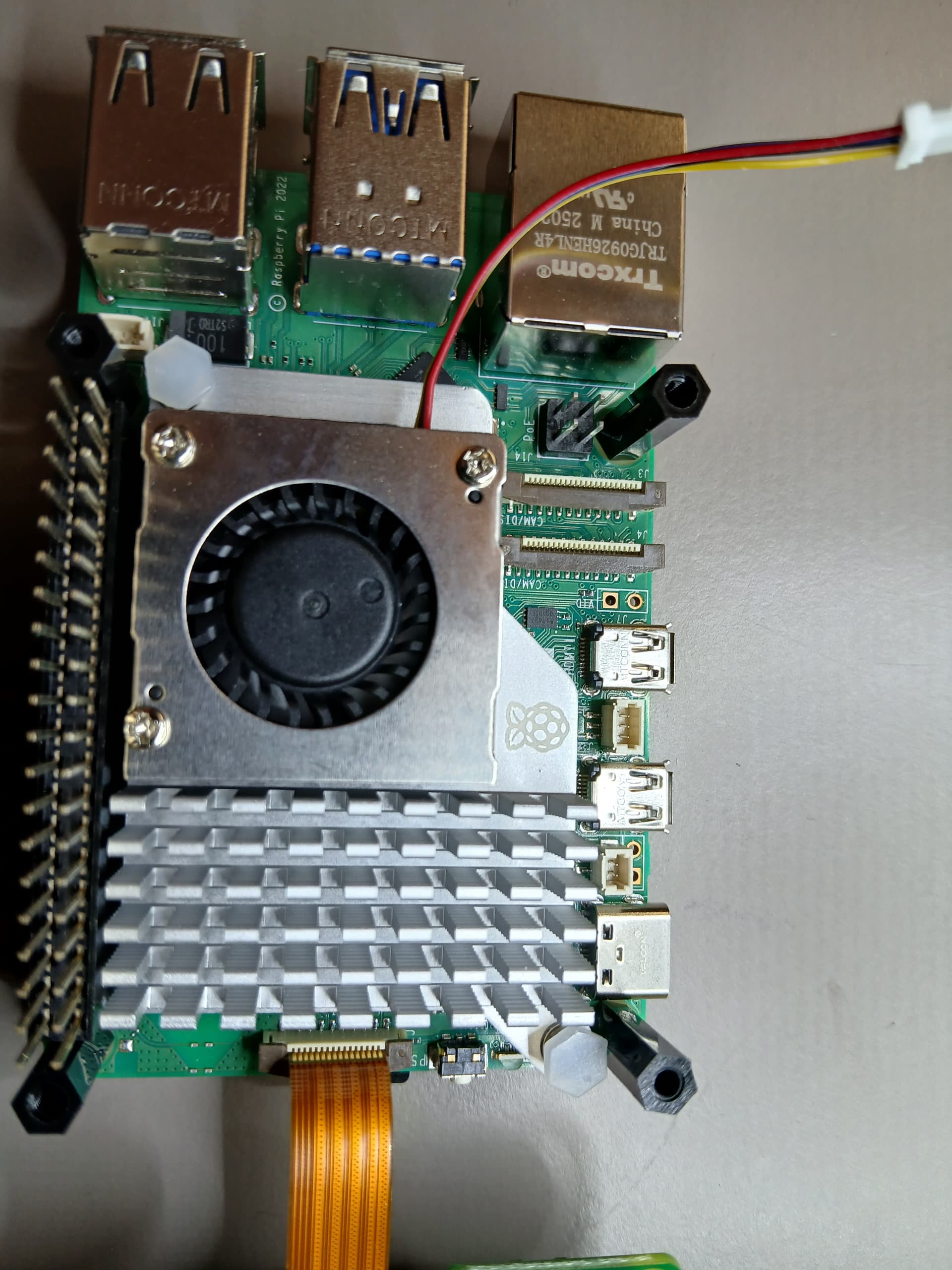

This picture illustrates the part of the assembly of the Active Cooler under the Raspberry Pi M.2 HAT+ with a Raspberry Pi 512 GB SSD.

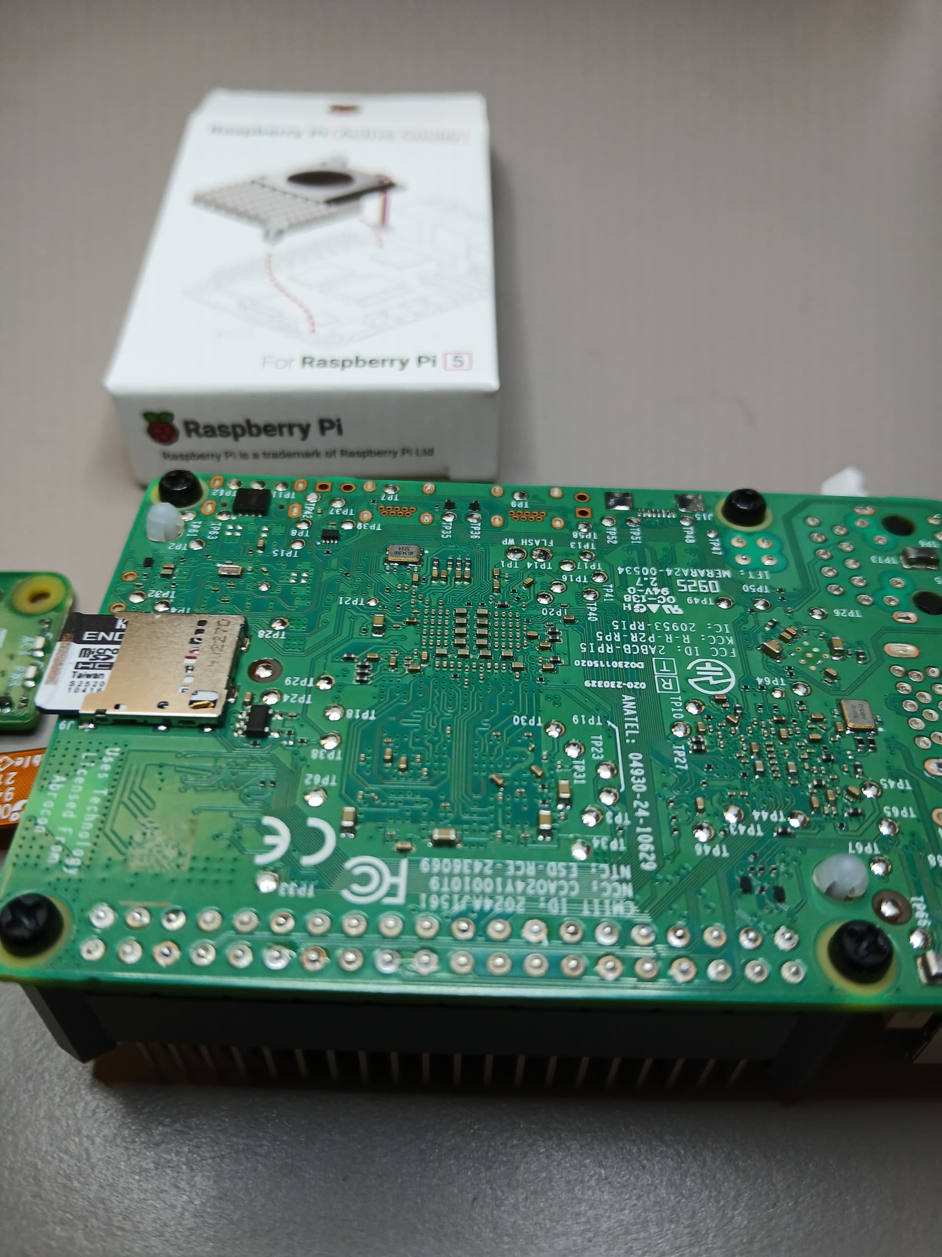

The previous picture shows under the active cooler area. This tape needs to be removed in order to attach it to the Raspberry Pi as shown in the next picture.

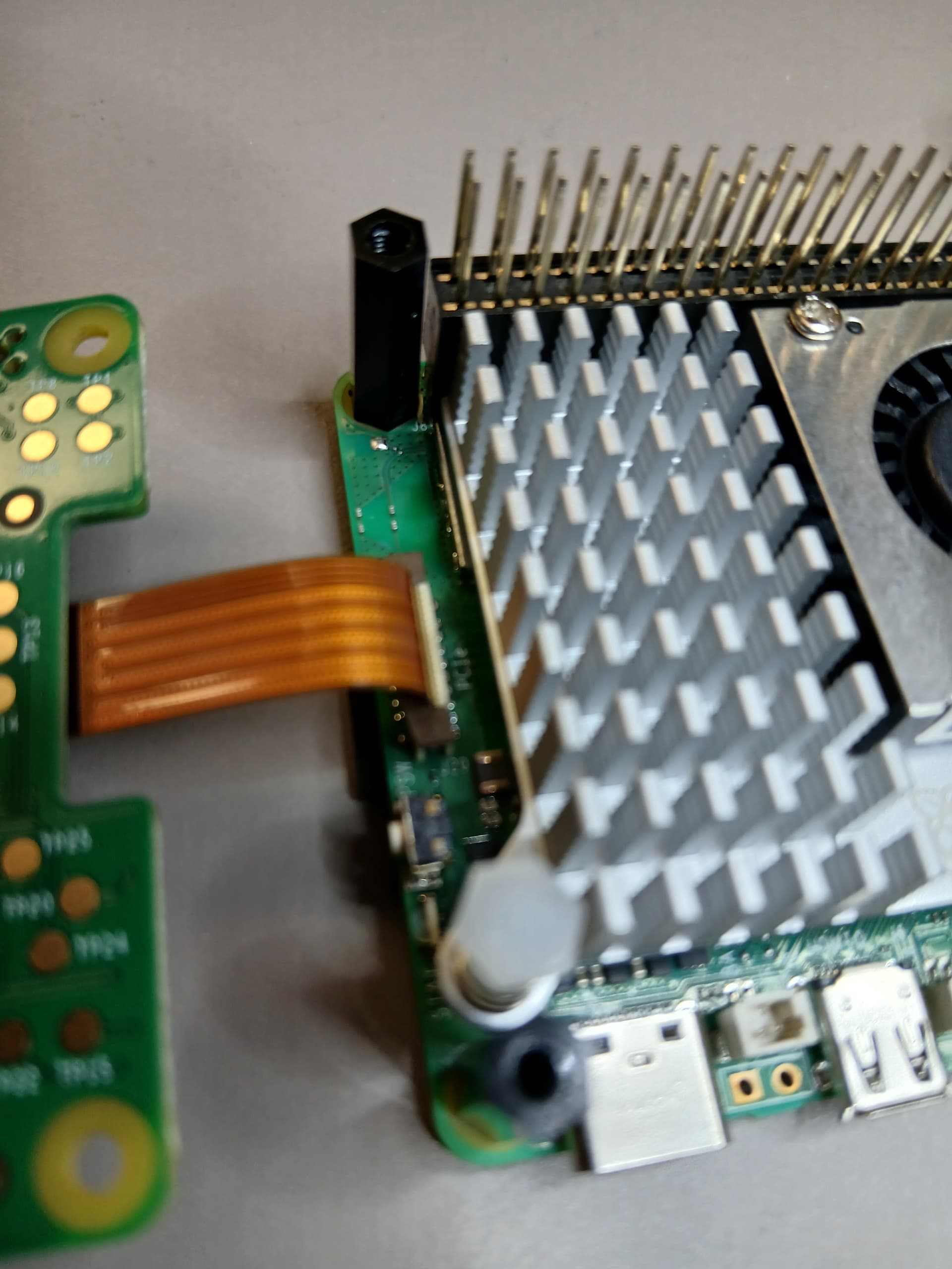

A closer look at the heatsink unit is shown next,
Once it is properly attached to the board using the plastic inserts connect the cable to the power port,
Here is a closer look at the plastic inserts under the board,

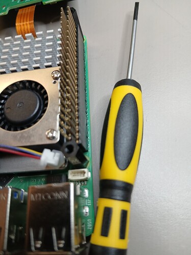

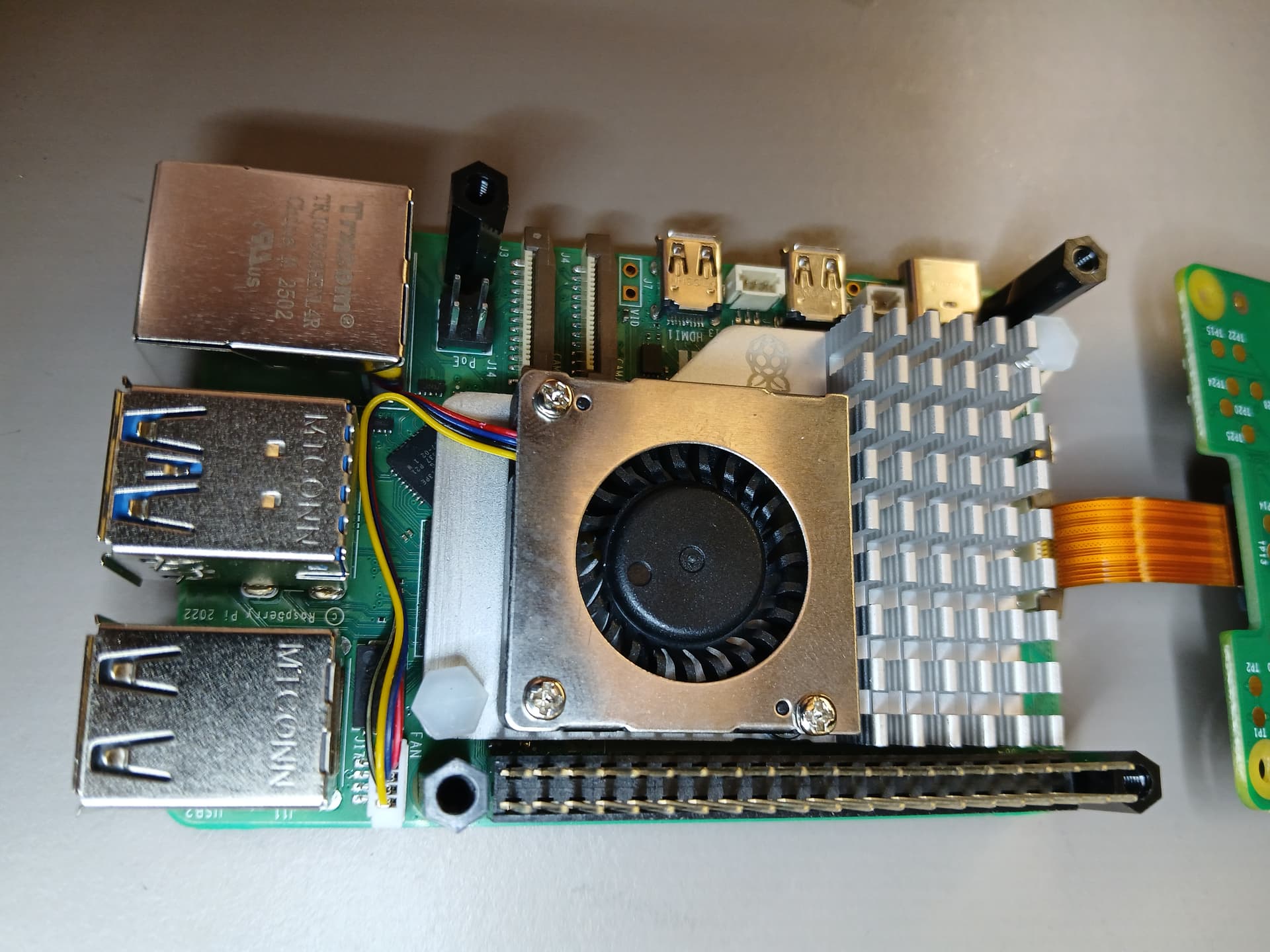

and a last look from the top to see the alignment,

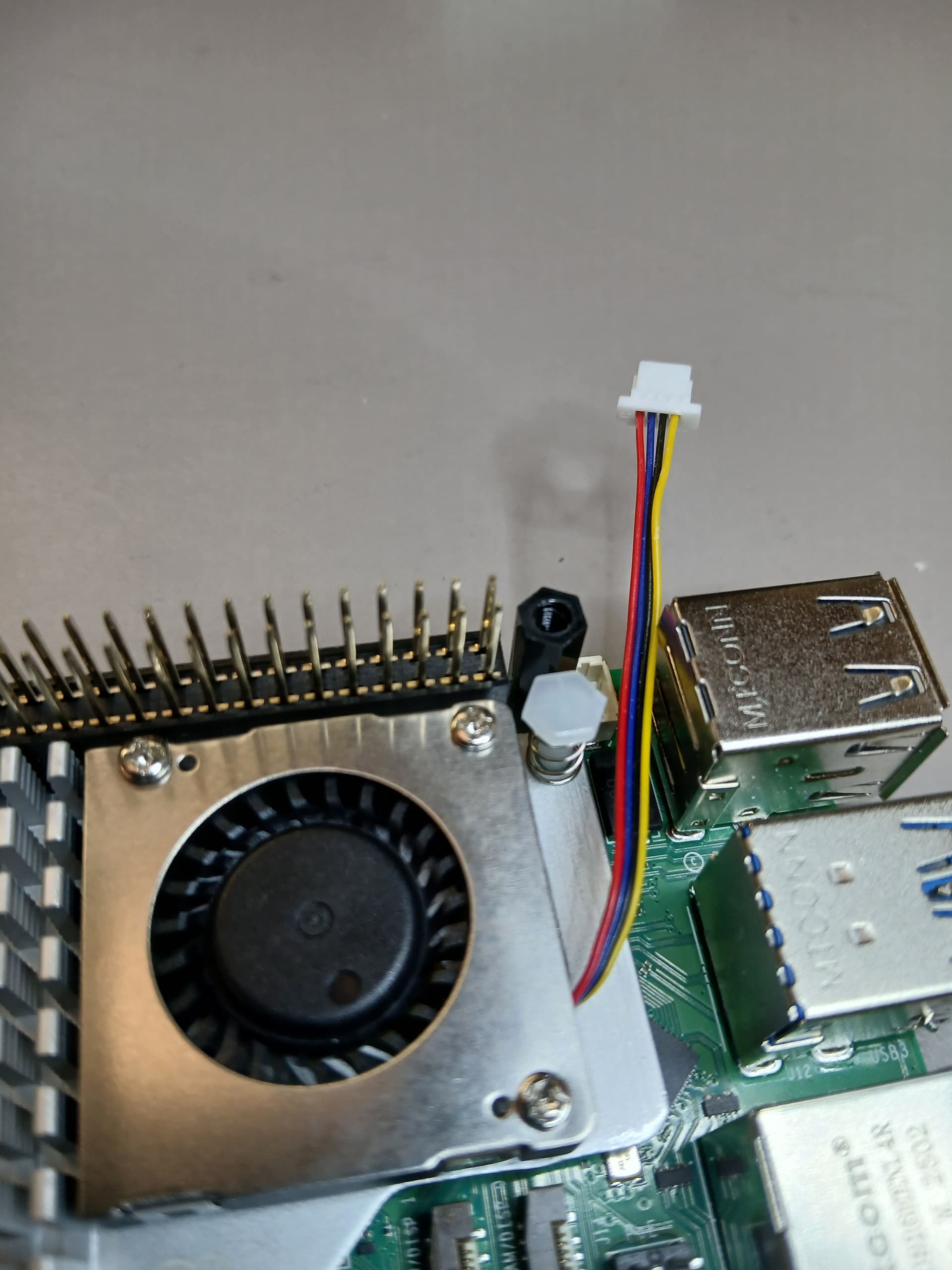

the next step is to connect the power cable,
as shown below,
Once that is properly connected then follow to,

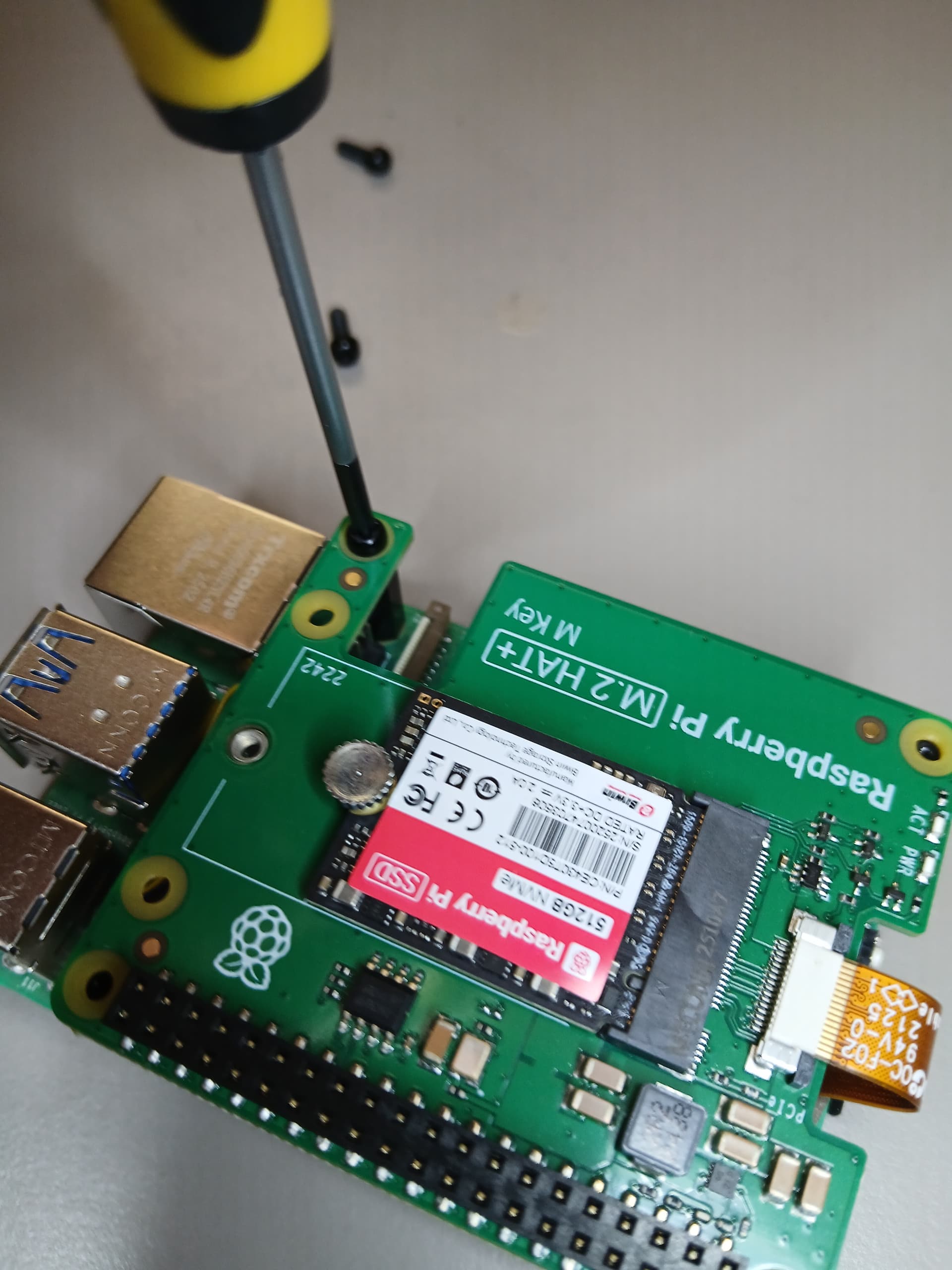

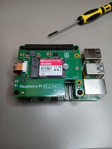

install the top SSD Raspberry Pi M.2 HAT+

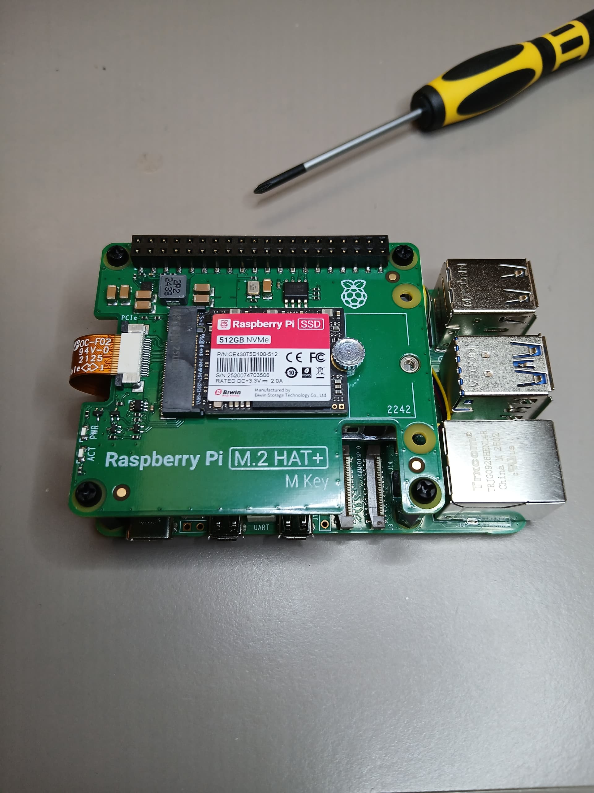

making sure the pins are aligned correctly as shown above do it gradually (illustration above shows the aligment process snapshot). Then attach the 4 plastic screws as shown below,

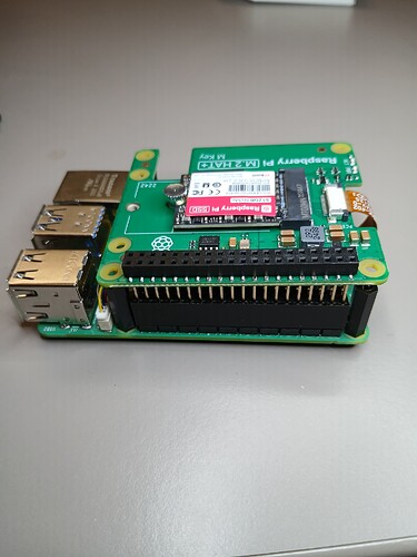

and finally here is the completed installation,
