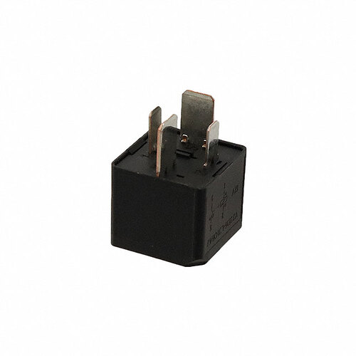

The closest thing I could find was this:
But from what my research tells me it will not simply reset using a pulse from the same switch due to polarity? It will need signal from a second switch to reset?

Yes, you generally need two independent switches to set and reset a latching relay.
I would not use latching relays in any device I expect to be buildable over the next 5 years. In this century latching relays are very expensive devices with limited usage because of the normal alternative. More and more of them go out of stock every year and get discontinued by the manufacturers.

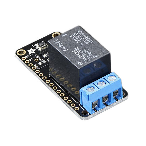

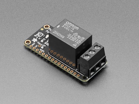

The normal alternative, for half to one tenth the cost, is to use a less than $1US microcontroller driving a regular low cost relay to replace any function provided by latching, time delay, and other unusual relay types.
You could use a full on easy to use and program microcontroller platform with a relay output accessory to prototype the system. Like these Adafruit Featherwing series parts:
The Adafruit learning pages linked from their product pages has a lot of details.

This one from Hella will work as a killswitch but from what I can see is only SPST and won’t switch between hi and lo beam headlights like an SPDT would.
These might do the trick but as you mentioned at significant cost these days.
The SAR 9200 as above seems to have been used on old VW beetles and kombis for this function.
I’ve been looking to find replacements for it like this perhaps

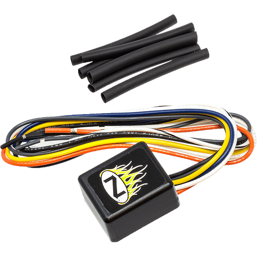

Guys I’ve found a retail product that does exactly what I want.
Hi/low beam and kill switch both in one simple, small module. No more, no less.
I have no idea how it took me literally two weeks of digging every day to find it but thanks for your help at least I have a solid grasp on how it all works now!
