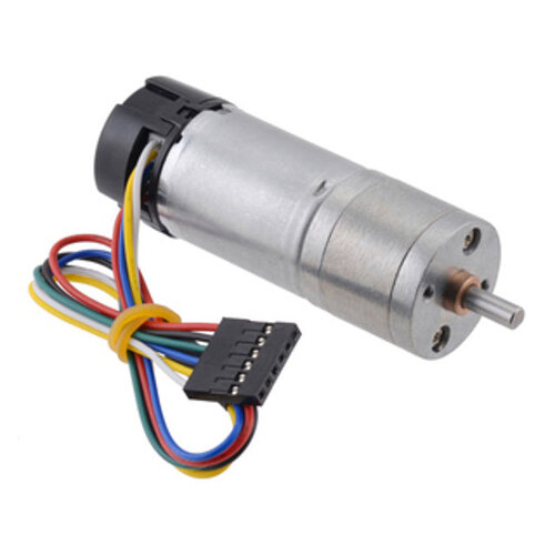

As a starting point, let’s assume this DC motor is used:
  1. We need to verify the motor has sufficient power to direct drive the safe.
  2. We need to verify that the lock members could be detected as a change in current.
  3. Since efficiency isn’t critical, recommend using a shunt resistor in the motor’s return leg and direct measurement to the microcontroller’s ADC (Microcontroller and power supply share common ground). Note that there will be challenges with start-up current and stiction in the motor’s geartrain. Also note that is a direct corollary with you Fluke experement.
  4. At this point we can use a bench DC power supply to run the motor. We can use the Arduino serial monitor to observe the current.
  5. Assuming the lock’s rotating members can be detected, the remainder of the project is constructed. This would include integrating the quadrature sensor and inclusion of a motor driver (linear?) to replace the power supply.

Hoping to locate a motor driver circuit that can accept the input from the quadrature sensor and as long as I can maintain a very low rpm and be able to detect the variations in current input and other variables to try to detect the changes in friction or frictionless movement changes.
Do you have any recommendations for a small linear DC motor, a driver circuit, and what type of sensor quadrature do you recommend to detect any other changes in the friction as it is rotating during a run?

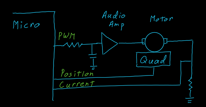

This chicken scratch drawing captures my thinking about this project.
  • We start with an analogWrite PWM signal. It is low passed filtered and sent to an audio amplifier which drives the motor. Note that you will need to add a relay to reverse the motor (not shown).
  • The motor’s return current is passed through a shunt resistor. This voltage is monitored by the microcontrollers ADC.
  • The quadrature encoder monitors the motor’s position.
Once again, I’m not convinced that this will work. The human hand is wonderfully sensitive and capable of making fast tiny movements. The motor system may not be sensitive enough and it will be slow. The added current to accelerate the motor and overcome gearbox stiction will always haunt the programmer.
I wish you well in this project. My hope is that you or other readers will overcome by pessimism or come up with a better system - perhaps a sensitive microphone on the safe to detect the click of striking lock members.
