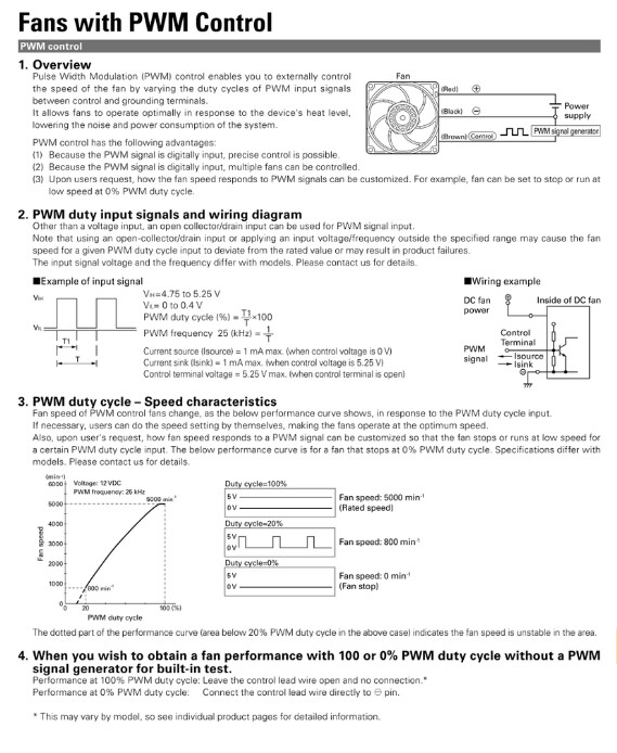

Hello, I recently purchased a Sanyo Denki 9GA0612P1H03 for a project. I tested out the fan using a power supply at 12V DC and the fan does not spin. I connected the red wire to positive and the black wire to negative. Any reason why this is happening?

I was looking over the information for the 9GA0612P1H03 and found the below information.
can you let me know if the brown wire connected to anything when you are testing the fan?
9GA0612P1H03 | Product Site | SANYO DENKI
Hello, the brown wire was not connected to anything. I only have the red and black wire connected to 12V power supply.
@eduardo65e78
A link to the information shown in the Screen shot from @anthony_14117
For the Brown lead you can apply a 5v supply to it to tell the fan to run at 100%
I connected the brown wire to 5v and still nothing.
