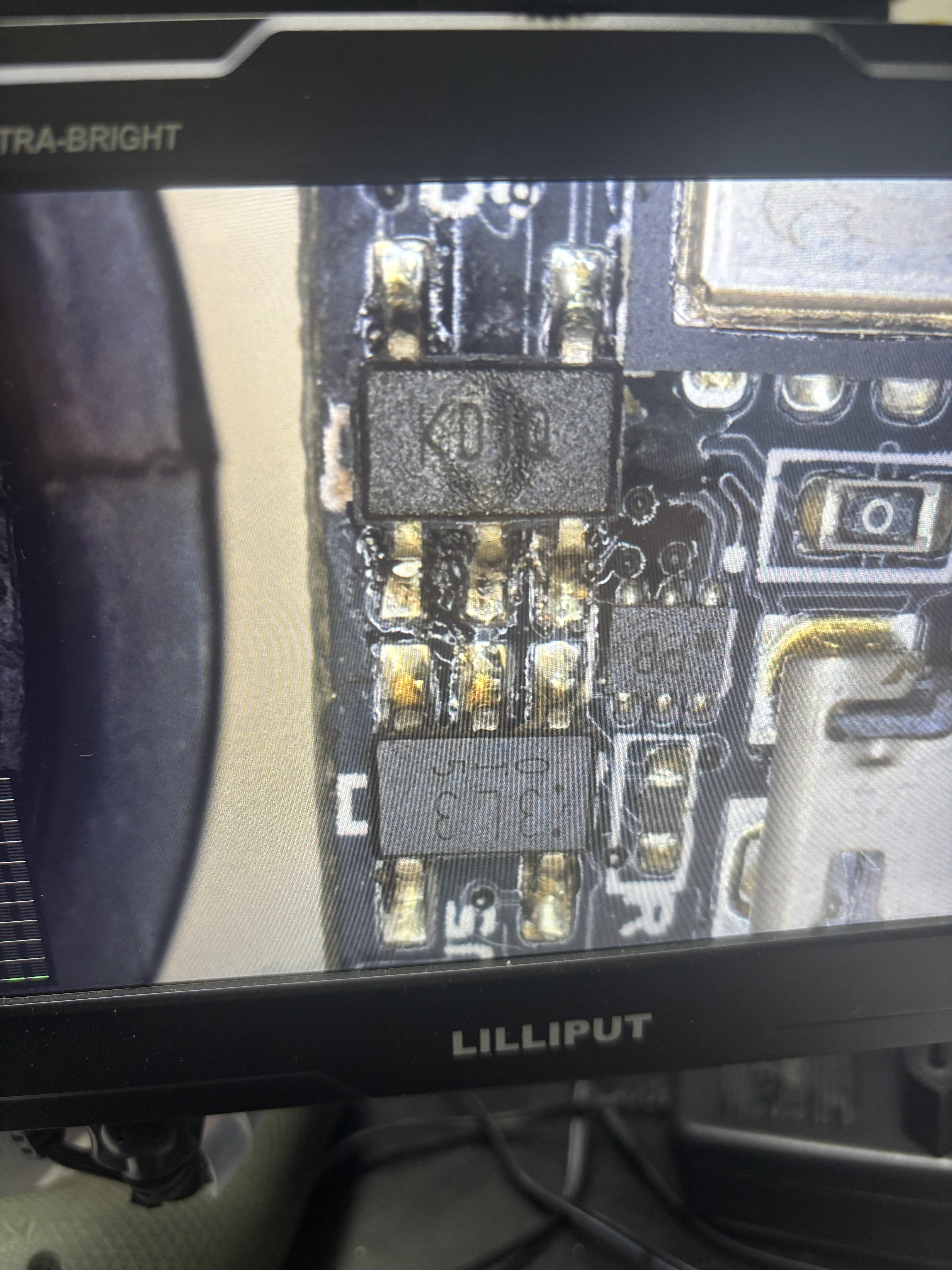

Hello All,
Can you please assist me to get the details of the below IC?
its label “KD1Q”.
I’m looking for an equivalent spare part.
Regards
Hi, primoz.

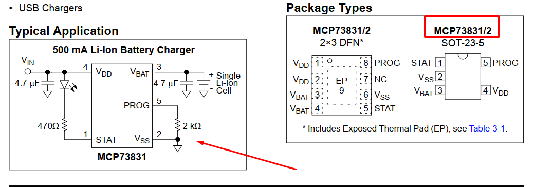

Should be MCP73831T-2ACI-OT.
Check it.
Regards,
Adam.
I believe you are right Adam7.
The datasheet for MCP73831T-2ACI/OTCT-ND, says the part markings are KDNN, and the NN would be the traceability code that would change.
