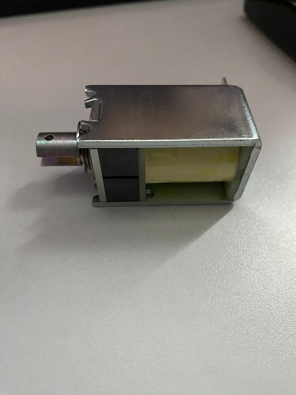

Hi David, I received the solenoid today. I am wondering if I misunderstood the meaning of a pull-latch solenoid. The solenoid arrived with the plunger inside, but since it’s in a de-energized state, shouldn’t the plunger be extended outward in its current state?
Hello hipoweredge,
The datasheet for this part does say that it supposed to retract when energized. This may have been energized and a pin put in to keep the spring retracted during shipment. Is there a pin/ring you can pull out and see if the spring extends?

Hi Klint,
I was suspecting the same thing, but I do not see any part that holding the plunger in. You can see in the pictures below from different angles. Appreciate if you can help to point out how to solve this. Thank you.
Hello @hipoweredge,
Intriguing component.
With your pictures, we can clearly see the permanent magnetics that hold the plunger in position.

Hello @hipoweredge,
Apologies for tripping on my own feet with this product (DSML-1153-24C).
The black components in the upper section are permanent magnets. The S and F terminals are polarity dependent.
The device has several states:
  • Deenergized:
    • the plunger is held extended by spring tension
    • the plunger will be held closed (latched) if it is physically moved pushed into the core
  • Energized with polarity of coil magnetic field adding to permanent magnet field
    • the plunger will be forcefully pulled into the core and held firmly in position
  • Energized with polarity where the coils magnetic field opposes the permanent magnetic field
    • (dynamic) Upon activation, the plunger is released (unlatched). Spring tension will extend the plunger.
    • (steady state) Once activated, the plunger will behave as if unenergized albeit with less force. The plunger will latch if it is mechanically forced.
Summary: The plunger is latched into position mechanically or by application of 24 VDC (positive to wide blade). The plunger is unlatched upon initial application of 24 VDC (positive to skinny blade). If the spring tension is insufficient or the load excessive, the plunger will remain in the latched position.
Tech Tip: This is a pull solenoid. The latch release mechanism (plunger push out) is passive. It’s also momentary. If the plunger is not immediately withdrawn upon application of power, it will remain latched. Consequently, this solenoid and associated spring have limited ability to push against a load. You may need to add additional mechanical mechanism to ensure the plunger is unlatched.
