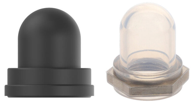

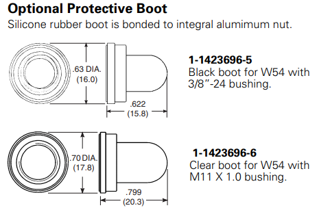

Splashproof Boots -TE W54, W57, W58 Series Circuit Breakers
There are two splashproof boot offerings in our system for these series, one being clear and one being black, but these are also different thread type. You need to make sure to order the correct thread type (size and thread count) when selecting a boot.
Per below image:
Black Boot: 3/8’’ -24 thread
Clear Boot: M11 X 1.0 thread
image of splash proof boot dimensional drawing switches circuit breaker DigiKey

image of splash proof boot switches circuit breaker DigiKey
