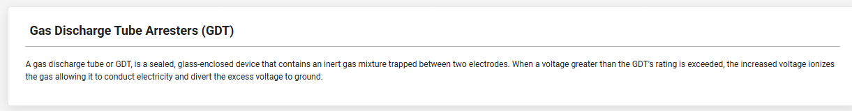

Lightning arresters are also called Gas Discharge Tubes (GDTs). Gas discharge tubes (GDTs) are sealed glass-enclosed devices with an inert gas mixture injected between two electrodes. When the voltage exceeds the rated value of the GDT, the increased voltage ionizes the gas, making it conductive and transferring the excess voltage to the ground.
