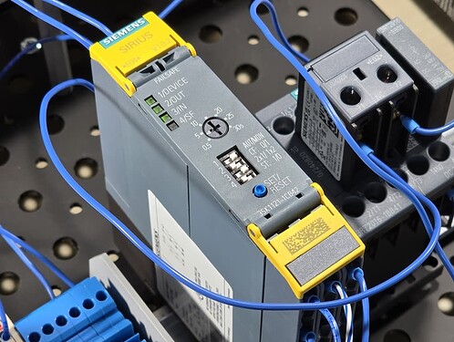

Which device was used for these measurements?
The measurements were made on the author’s workbench using a Siemens 3SK1121-1CB42 along with a Digilent ADP2230 mixed signal oscilloscope.
Figure 2: Image of a Siemens SURIUS 3SK1121-1CB42 on the author’s workbench.
