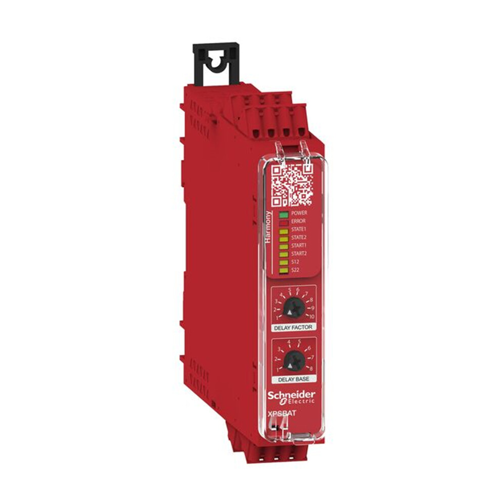

The standardized OSSD signal allows the designer to select compatible building blocks to best suit their application. As an example, consider the Schneider Electric XPSBAT12A1AC safety module. Standardization may allow the SICK light curtain shown in Figure 1 to be used with the safety module shown in Figure 2 (see subsection below).
From the Schneider datasheet we see these specifications:
  • Input compatibility: OSSD pair IEC 61496-1-2
  • Safety level: Can reach PL e/category 4 for normally open relay contact ISO 13849-1
  • Safety reliability data: MTTFd > 30 years ISO 13849-1
DigiKey offers many additional safety modules and PLC safety modules from trusted manufacturers. This flexibility is beneficial when we consider the long service life of industrial equipment or the occasional supply chain disruptions.
Figure 2: Image of the Schneider Electric XPSBAT12A1AC (Harmony) safety module featuring OSSD inputs.

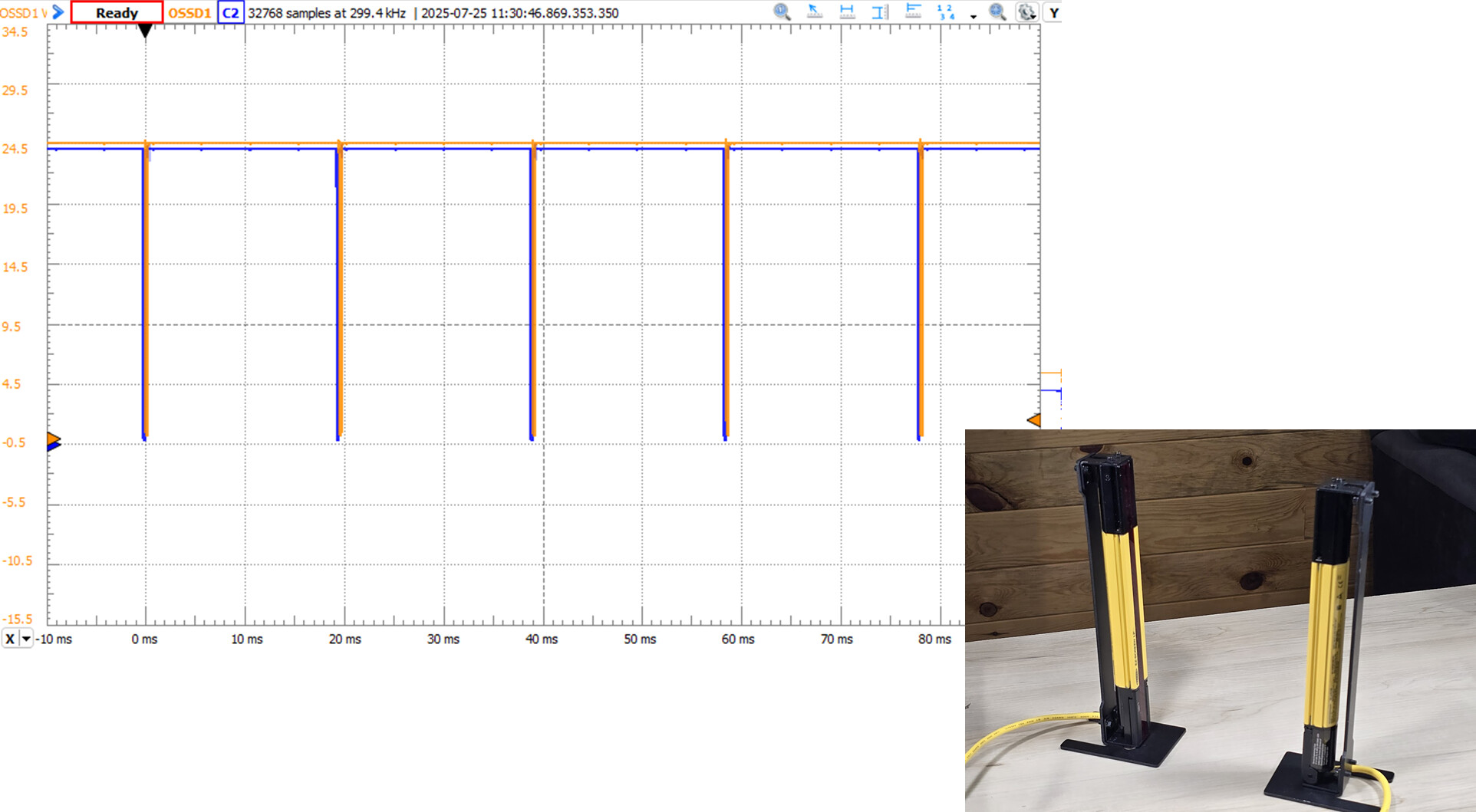

Do all OSSD signals share the waveform and timing characteristics?
While the general idea appears universal, experiments suggest the timing varies between manufacturer and possibly across product lines. For example, the SICK signal (Figure 1) contains two signals offset in phase with a 100 ms signal event. However, a Banner Engineering SLPR14-270 light curtain as shown in Figure 2 has near simultaneous pulses with a 20 ms repetition period.
Figure 3: OSSD waveform for a Banner SLPR14-270 light curtain.
