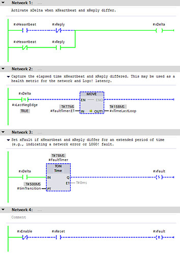

The core ladder logic functionality is included as Figure 4. The key is to monitor xHeartbeat and xReply. This operates like a watchdog timer where the S7 expects to be fed by the LOGO!.
xHeartbeat: The heartbeat is a pulse per second signal with a 50% duty cycle that is sent across the network to the LOGO!.
xReply: The xReply is simply an echo, the LOGO! receives the byte from the S7 and then transfers it back to the S7 once per scan cycle.
As shown in the Figure 4 ladder logic, Network 1 performs an XOR operation to determine when xHeartbeat is different from xReply. Under normal operation, xReply is always slightly behind xHeartbeat for every 0 \rightarrow 1 or 1 \rightarrow 0 transition. This reflects the network latency and the time it takes for the LOGO! and S7 to perform their scan cycle operations.
Network 2 captures the transition latency time. See the results section for more information.
Network 3 includes a time-based trigger (TON function) that will set xFault if xReply does not respond fast enough. The reset logic is shown in Network 4.
Figure 4: Ladder logic function block allowing the S7 to monitor network and LOGO! connectivity.
