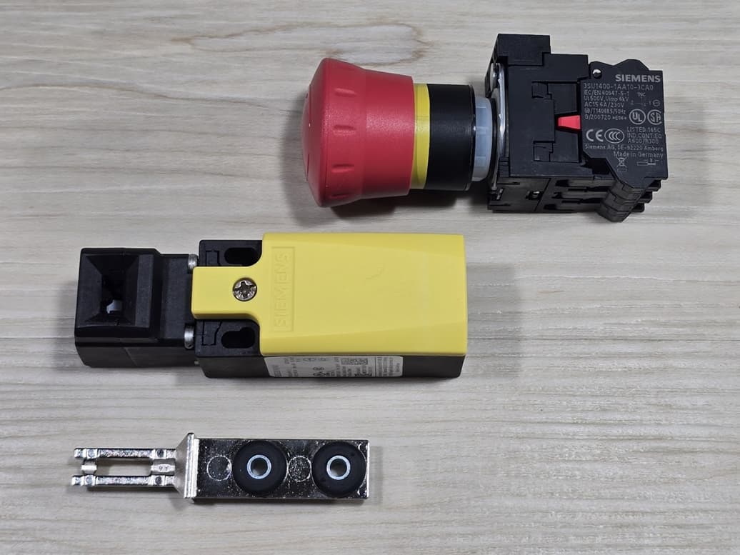

In this engineering brief, we explore the Siemens 3SE52320QV40 and the associated 3SE50000AV01 die-cast key, as shown in Figure 1. When properly installed, this switch may be used to monitor the status of a door. According to this Siemens document, the switch may provide protection ranging from Safety Integrity Level 1 / Performance Level c (SIL 1 / PL c) up to SIL 3 / PL e with the understanding that the switch alone can be rated no higher than SIL 2 / PL d.

Figure 1: A Siemens E-stop switch (top) shown with a door monitoring switch with separate actuator (middle/bottom).

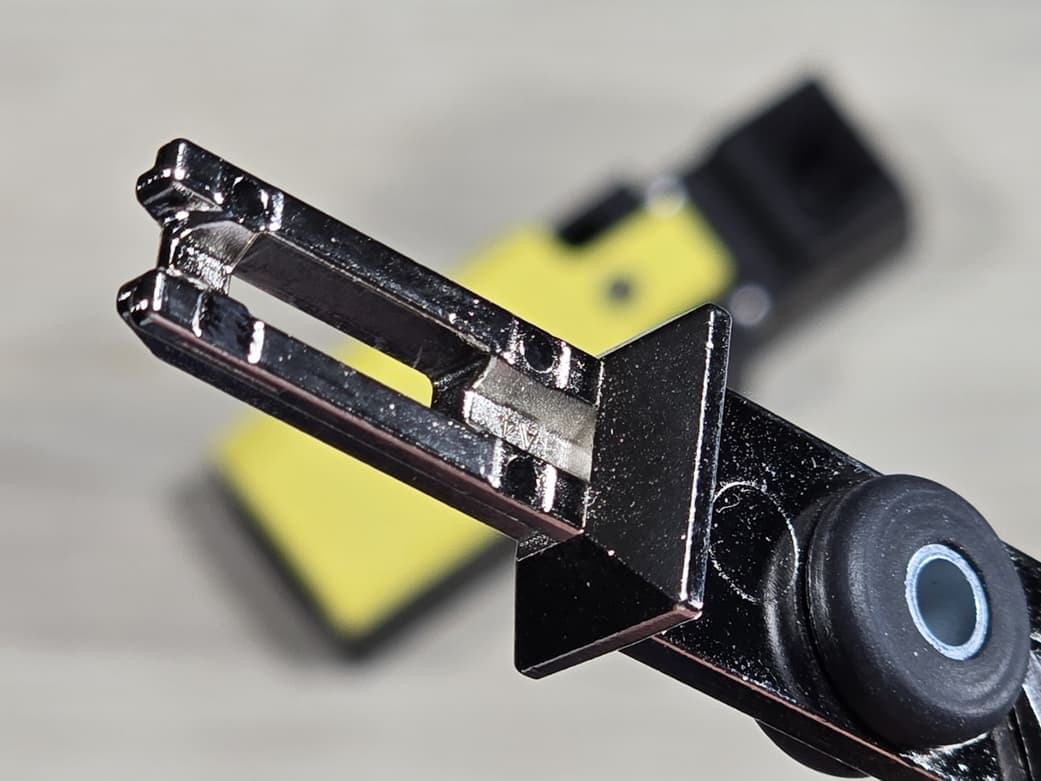

Tamper Resistance
The door interlock has a matching key (close-up image in Figure 2). This prevents the operator, or more likely, a technician from defeating the mechanism. However, this is not 100% safe as a clever and dedicated technician may “pick” the mechanism or simply pull another key from stock.
Tech Tip: Consider adding an RFID-based safety interlock for door detection. An example is the Siemens 3SE63 series.
While nothing is completely tamper-resistant, the RFID is harder to defeat than a mechanical switch. There may also be a safety benefit from using multiple switches where different technologies are incorporated. Consult a qualified safety engineer.

Figure 2: Close-up image of the external actuator showing the key-like tamper-resistant slots.
