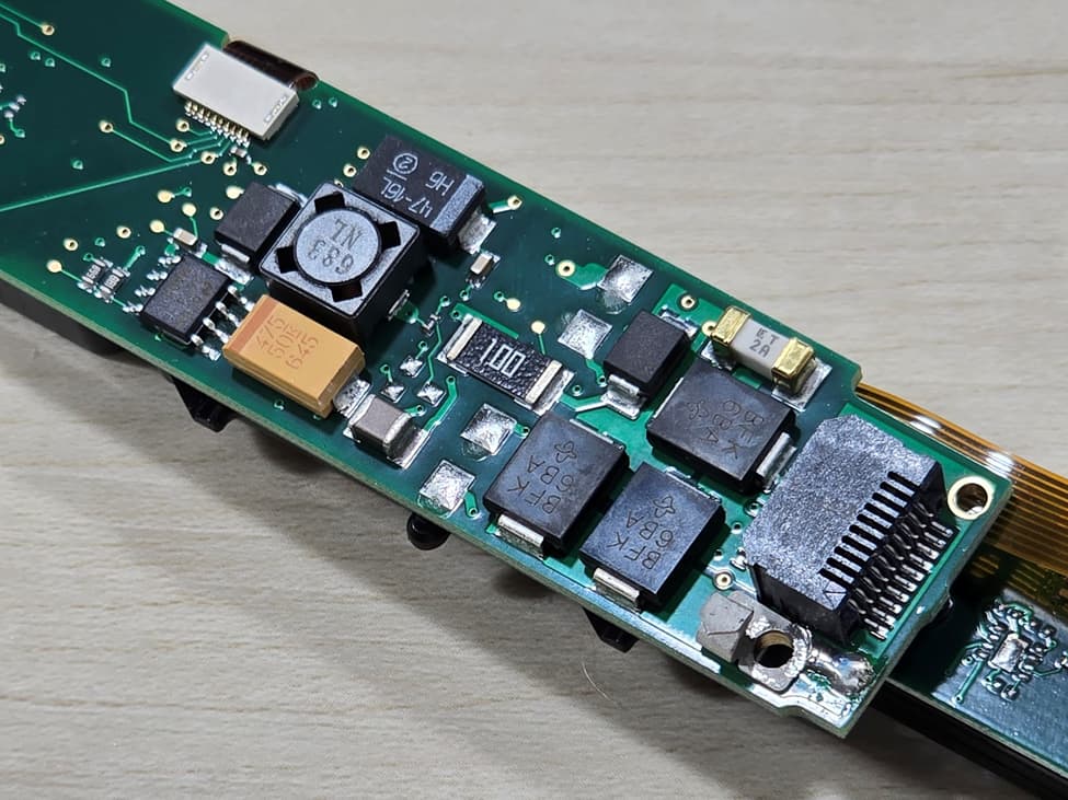

Power Supply and Input Protection
As a general statement, industrial components are designed to a high standard when compared to general electronics assemblies. This is doubly true when we consider that a light curtain is a safety device designed to guard a machine. We would expect nothing less when we consider the power supply section of the light curtain as shown in Figure 4:
- Bidirectional TVS for transient voltage suppression
- Polarity protection for those moments when we forget that brown is hot (24 VDC)
- Fuse protection
- Low voltage switch mode power supply for the microcontroller

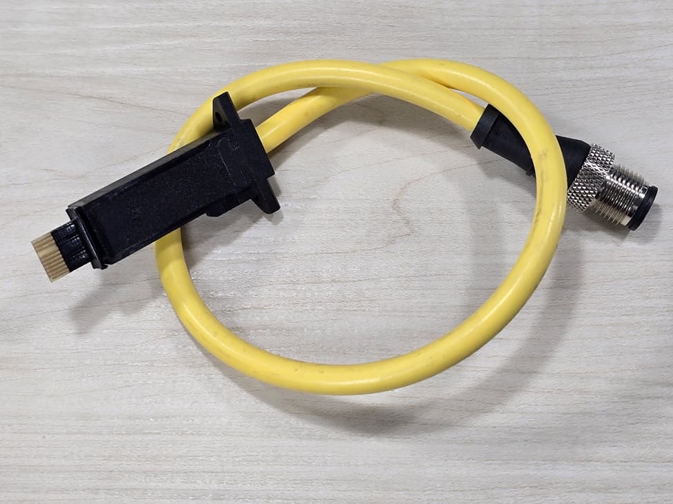

In addition, we also see a connector for the external cable. The matching card-edge connection is shown in Figure 5.
This Banner Removable Disconnect (RD) is a convenient design feature as many different cable lengths are available to match your project. For example, DigiKey offers cables ranging from the short M12 connector all the way to 100-foot (30.48 m) cables with flying leads. Be sure to consult Banner’s EZ-SCREEN LP (Low-Profile) Safety Light Curtain Instruction Manual.
Figure 4: Light curtain power and input protection circuitry.
Figure 5: Light curtain cable with card edge protection leading to a M12.

At the same time, take every opportunity to safely examine unserviceable equipment and see how it is assembled. For example, reverse-engineer the power section as shown in Figure 4. Learn electronics by understanding the relationship between the bidirectional TVS diode, polarity diode, fuse, and I/O signals.
