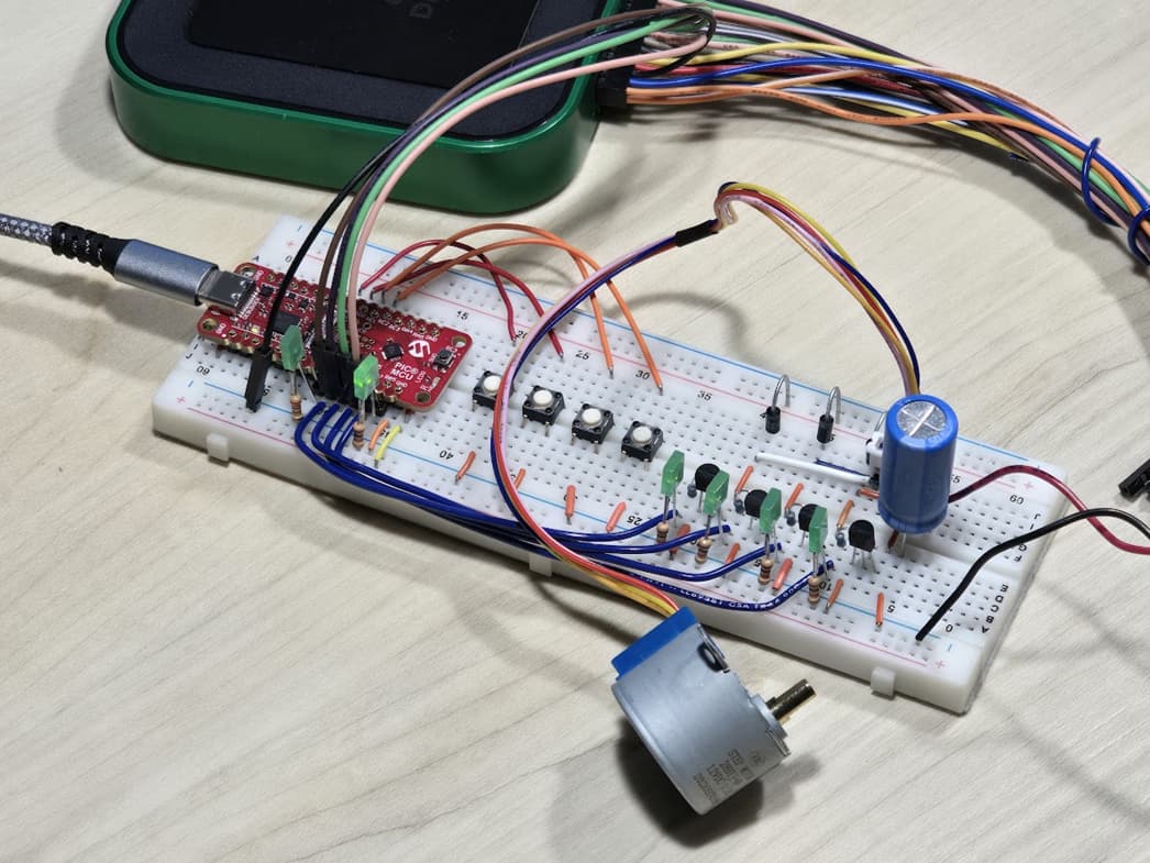

This engineering brief demonstrates the PIC16 Configurable Logic Block (CLB) by controlling the stepper motor as shown in Figure 1.
  • The CLB fabric operates independently of the PIC16 microcontroller core.
  • A half stepping control is used for the stepper motor.
  • The motor is controlled via a direction and an enable pushbutton.
  • The motor operates at fixed speed as programmed by the user.

Figure 1: Stepper motor drive used in the demo project.
Do not cross the 3.3 VDC supply with the 12 VDC.
:warning: In Figure 1 we see that the breadboard’s upper rail is connected directly to 12 VDC. Do not connect the PIC’s pins to this rail. You will smoke the PIC if you do.
I’ve been there and can tell you that it happens very quickly. The PIC explodes and things only get worse when the USB port in your PC burns out. It’s a costly lesson you will not forget.

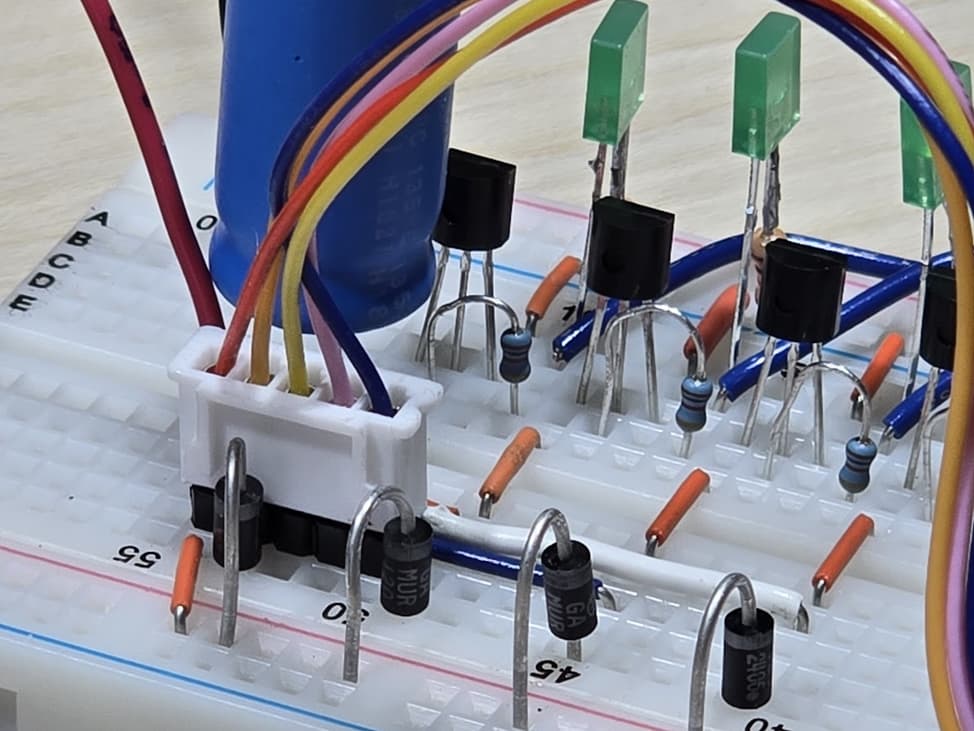

Figure 2: A flyback diode is included across each motor winding. A series resistor is included for each transistor base.
Tech Tip: Don’t forget to place a flyback diode in parallel with each motor winding. Failure to include the diodes will result in high voltage spikes that will destroy the 2N3904 transistors. The diodes are prominently shown connected to the breadboard rail in Figure 2.
The transistor base current limiting resistors are visible in the background.

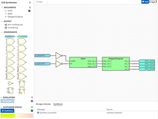

Verilog Programming of the Stepper Motor Control Logic
The top-level control logic description is included as Figure 4. It includes two sections:
  • State: This module accepts the enable and direction input from the pushbuttons. It maintains the 3-bit state register controlling the half stepping sequence. The code is included as Listing 1. There we can see that this module operates as a 3-bit up down counter.
  • Stepper_Outputs: This module accepts the 3-bit state and produces the required output signals as shown in Figure 5. The code is included as Listing 2. The module operates as a decoder with the core operation implemented as a lookup table.
The modules were constructed independently to simplify troubleshooting. The state module was constructed first. It was temporarily connected to the PIC outputs, and the operation was verified using LEDs.
Note that the stepper motor project consumes approximately 50% for the digital logic fabric.
Figure 4: Top level logic description showing two Verilog modules.
