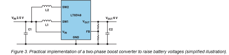

What makes this topology especially efficient is a technique known as phase shedding. At low load currents, only one phase operates, reducing switching losses and power consumption. If the system later demands more current (several amp), the second phase automatically activates, delivering full two-phase performance.
This improves efficiency across a wide range of currents, reduces switching losses, and makes the converter ideal for applications like battery-powered systems where the load can vary significantly.
The example circuit in Figure 3 converts 2.5 V supply voltage to 6 V output voltage. At 3 A load current, an efficiency of 92% is achieved. With a load current of only 2 mA, an efficiency of 90% can be measured.
