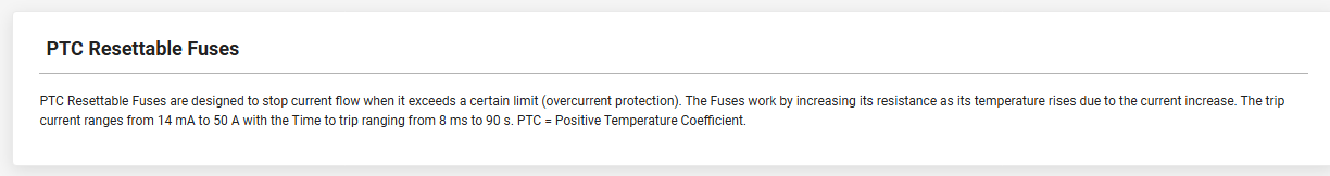

In addition, what is the principle of the PTC self-resetting mechanism?
PTC uses the positive temperature coefficient effect of its material and the dynamic balance of heat to achieve overcurrent protection. When the current is too large, the PTC quickly enters a high resistance state, limiting the current flow and thus protecting the circuit. This self-resetting mechanism allows the PTC to remain effective in multiple overcurrent events, providing continuous protection for electronic equipment.
