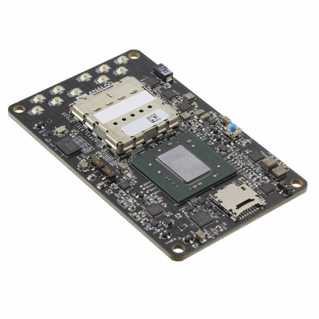

As a rule, only devices intended to live on cellular networks come with IMEI numbers. RF devices that do not interact with cellular networks, such as Bluetooth, Wifi, or other standards, do not need, cannot use, and thus do not come with IMEI numbers. Cellular products that are intended for evaluation, such as Analog Devices’ ADRV9361-Z7035 board, aren’t issued IMEI numbers as those devices aren’t intended for long-term use on cellular networks.
